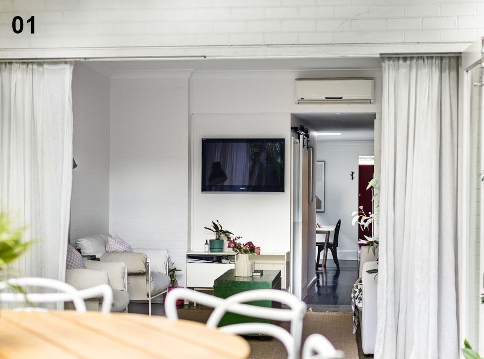

We have just purchased a home, we haven't moved in yet, so excuse the limited photography.
  • This back wall in the first image has a drop (250mm) where the brick meets the laundry. This has a (relatively) small TV mounted

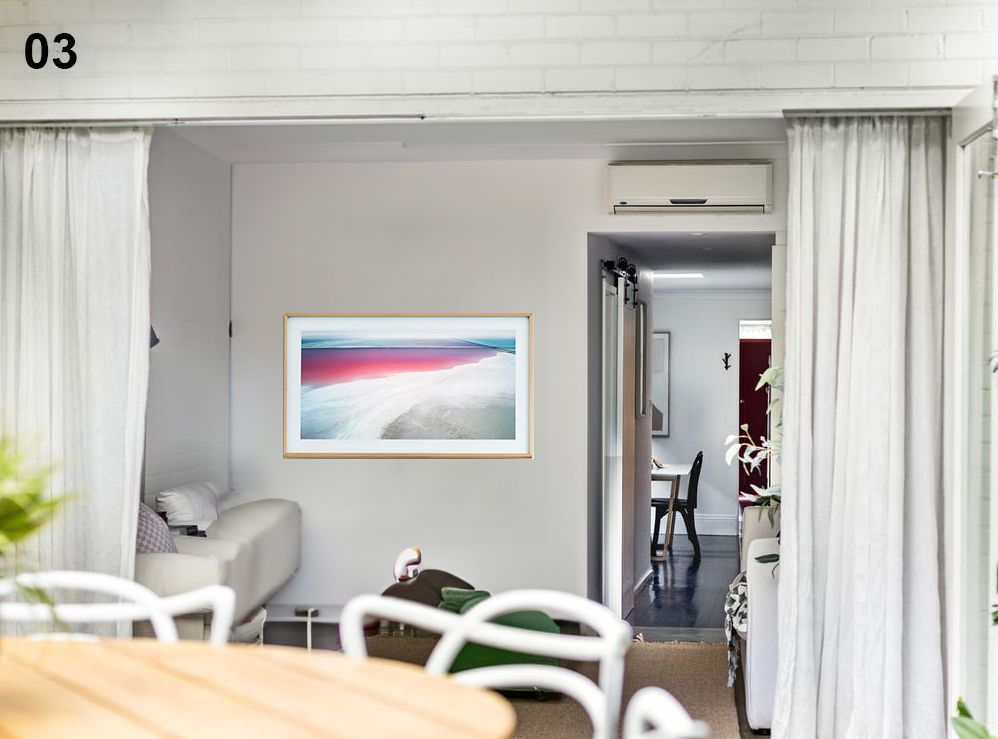

  • I wish to mount a larger, Frame TV, and make that corner feel a lot more refined
  • Thoughts on how this would be done, not necessarily by me, but just so I have a good guide of what needs to occur
From what I can tell, will need to build a timber frame to house plaster – and it getting a bit tricky where the plaster meets the brick, and evening that out across to the cornice and skirting (and then electrical).
Would love other ideas of what I can do with this space. The room isn't large, and losing this surface isn't really on the cards unfortunately.01.jpg02.jpg03.jpg

Your analysis is correct, a timber frame will need to be built into the gap. The timber frame will need to be anchored to the brick wall, any electrical or networking points will need to be extended by an electrician so that it reaches the front of the frame. It would be a good opportunity at this point to install extra timber noggins in the frame so that you have a strong fixed point where to anchor your TV mount.
The plaster board is then installed and plastered over so that it blends in with your existing wall. The power point access is cut and is fixed in front of the plasterboard. It's technically finished and the Tv is then mounted to the wall.

Hi @newtoallthis I'm a little confused this drawings I supplied (though might have been difficult to understand), essentially was to build out the two recesses in that L-shaped wall to allow plasterboard to be fitted flush right across to get the look your after in your photo 3.
The recessed wall the TV is mounted to in Pic 1 is deeper than the small section of wall above it, which is a shallow recess compared to the main brick wall. Hence the 2-stages of building a frame to make it all flush. It would make sense to whoever was building it if not yourself.
