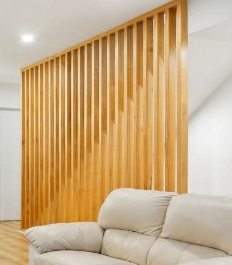

This is my feature wall, its 90x45mm verticals. i would like to attach my TV on this but without any damage to it

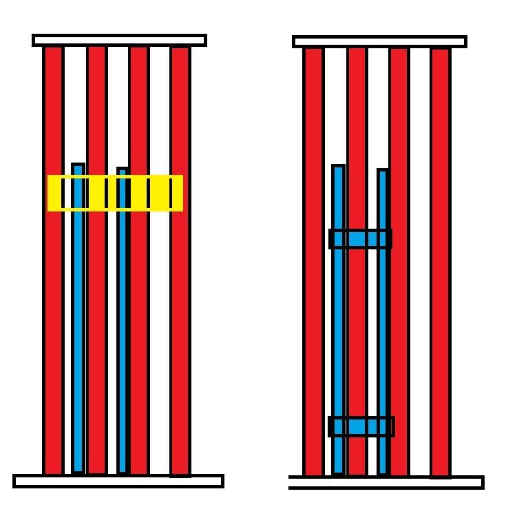

My idea is 2x  Vertical posts which are held against the feature wall with horizontal wood on the back and the TV bracket at the front. My question is what sized timber do i need as Bunnings doesn't sell 4x2 (90x42) on thier web site and i need 1800mm high?
The total weight is 40kg. So what thickness of wood do i need?

4 x 2 in Australia and NZ is milled to 90 x 45mm. You'll find 90 x 45mm SG8 H1.2 KD Treated Radiata Timber Framing - 6m. The 6m length would need to be cut down to suit your 1800mm high increment.
Provided you secure this structure together sufficiently, then the 45mm thick timber would be adequate.

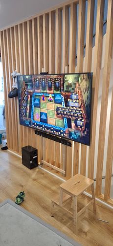

All worked out great. Took 20mins to put together and bunnings helped by cutting the wood
Thanks again 

Thank you very much for the update. That TV mount looks excellent; It took me moment to realize that the TV mount was mounted onto another timber piece and not your feature wall. For extra safety, I suggest installing a horizontal piece on the other side of the stand to prevent it from tilting out.

Finished product
Re: How to hang 40kg TV without damaging feature wall?
Hi @kiwigunner
Thank you for sharing those TV updates, The mount looks very good and blends in very well with your feature wall.
