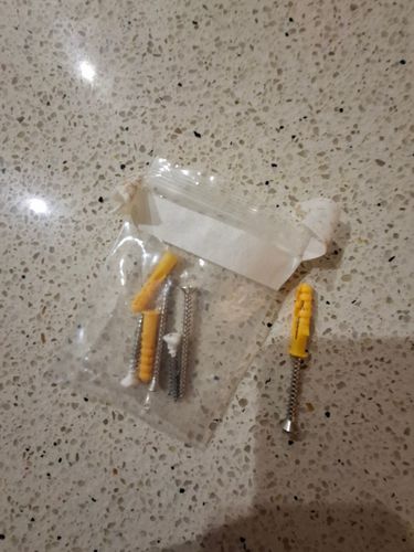

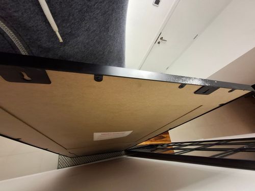

Need to hang 25 kg Astin sinclair grid mirror(bunnings) on a plasterboard. The anchor provided with it seems to be very week

I suggest looking at using Ramset Super Wallmate Toggle Anchor - 10 Pack in combination with Everhang 20kg Heavy-Duty Solid Wall Picture Hanging Hook - 12 Pack. I recommend a minimum of two screws and hooks for each mirror to spread the weight of the mirror. My best advice is to drill pilot holes into the plaster wall for proper installation.
