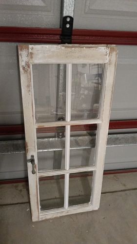

I have started my very first DIY project which consist in sanding some old timber window frames to use as a picture frame.
I have done the sanding and it turned out great, now given that i don't really own power tools, i need to know how to hang the heavy (10 kilos approx) frame onto my drywall.

In order to give our members a better idea of the size and shape of the frame along with how thick the timber is, would it be possible for you to post a picture of the frame itself. Once we see it, we'll be able to offer recommendations on how to hang it.
However, just to give you a few ideas on how to hang a heavy picture frame, I often suggest using Ramset Super Wallmate Toggle Anchor - 10 Pack. This has an anchor that drops behind the plaster wall to provide a positive hold. Then there is the Ramset 6 x 38mm Universal Anchor - 6 Pack combined with the Everhang 20kg Heavy Duty Solid Wall Picture Hanging Hooks - 12 Pack. These screws are designed to be used on all substrates and the hooks are capable of holding 10Kgs. I also recommend using Everhang 15kg Zinc Plated Heavy Duty D Ring - 4 Pack to be used at the back of the frame.

Thanks so much for you reply!
Attached is a photo of the frame. Actually it is not as heavy as I had thought at first. Maybe 5 or 6 kilos.

Hello @Milo75
Thank you for sharing a photo of the window frame. I suggest using Ramset Super Wallmate Toggle Anchor - 10 Pack in combination with the Everhang 15kg Zinc Plated Heavy Duty D Ring - 4 Pack. I suggest a minimum of two D Rings per frame, one on each side.
