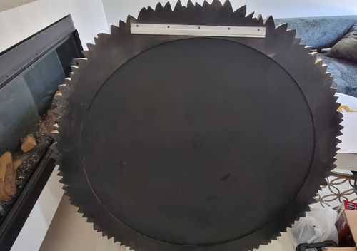

I have a big mirror I need to hang on to the wall(pretty sure it's a gyprock). Mirror has hanger at the back as per photos. Didn't try yet to find studs, maybe one there maybe not. Can you please guide me which hardware is the best to use to complete this job?

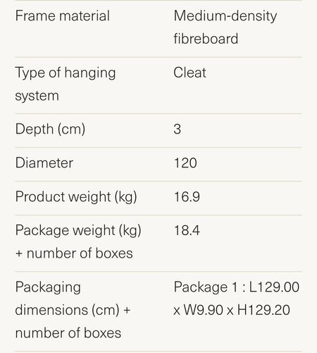

Can we start by getting you to weigh the mirror so we have a bit of an idea of what fixing might suit? However, you're always going to be best fixing directly to a stud and not plasterboard.

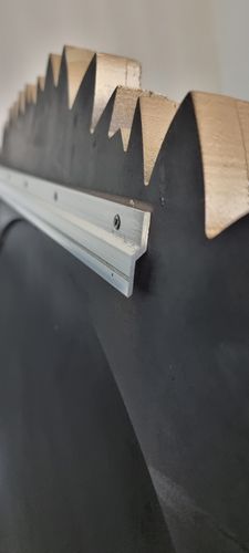

That's a bit of an unusual bracket on the back of the mirror. Were you supplied something that looks similar that is to be mounted to the wall? I would presume that the same would be attached to the wall, and then they would mate together. If not, then the next best option would be to drive a screw, or two screws side-by-side, into a stud and have this bracket hang on their heads.

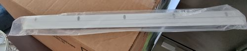

Base on manufacture information, this mirror should be arround 17kg. And also there is part Similar to attach to the wall.

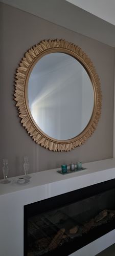

This one finally completed. 😀
