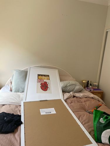

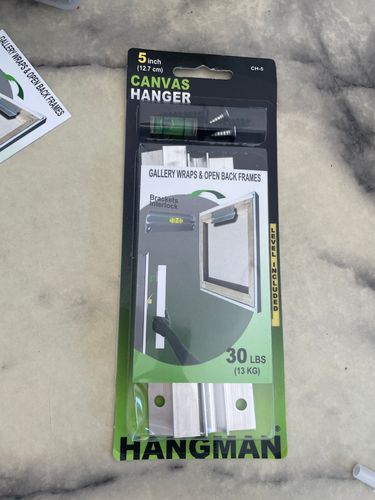

I have two large poster frames around 5-10kg and I want to hang them side by side above our bed. It’s plasterboard and I don’t have a stud finder, so it’s extra hard to secure things! I bought the hangman canvas hangers, and tried using wall plugs with them too but the wall plugs just keep falling into the wall when I put screws in!

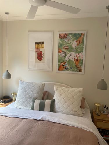

It worked out great with the zinc alloy screws! Thanks Eric! The 3M claws I got didn’t work out well with the type of frames I have because you could see the claw from the top! But it looks awesome! Thanks again for your help!

If your canvas picture has a timber frame, I suggest using the same picture hanging system that Sarah used which is the Hangman 13cm Canvas Picture Hanger. If you are fixing onto standard plasterboard, I suggest using the Ramset 8 x 64mm Zinc Alloy Toggle With Screw - 2 Pack for a secure hold.
