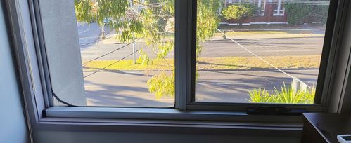

The present window opens outwards on one side only. There is too much traffic noise . Instead of replacing the window with a double glazed window, can I just add a normal glass window in addition on the inside and leave the outer original . So it acts as a double glazed window. The window size is 1400 X 1200 mm.

That definitely sounds like a possibility—as long as there’s enough room within the existing window frame or reveal to install the additional pane. If space is tight, you may need to make some alterations to accommodate the extra glass.
What you're describing is often referred to as "secondary glazing," and it can be a really effective way to reduce traffic noise without the full cost or effort of replacing the existing window. Even a single pane of glass with a decent air gap between it and the original window can make a noticeable difference in sound insulation.

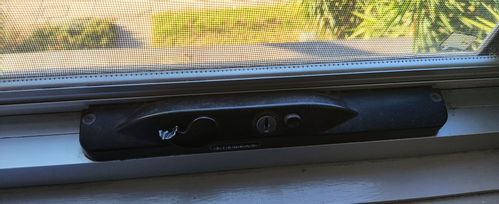

Thanks Mitchell, there is 40mm of frame that I can fit this on. I want half to open inside. So I can open the outer window if needed. Where can I get this done? I can fix it myself.

Since Bunnings doesn’t stock window units like this, you’d likely need to have a slimline frame custom-made to suit your available 40mm space, especially if you're after one side that can open inwards. That’s not a common off-the-shelf option, so it would require either a local window fabricator or glazier who can build something to your exact needs.
If you're fairly handy and open to researching how window systems are installed and sealed, it’s definitely possible to take this on as a DIY project. Just be mindful of getting a good air seal and maintaining a clean gap between the panes, as that’s what helps reduce the sound transfer.
