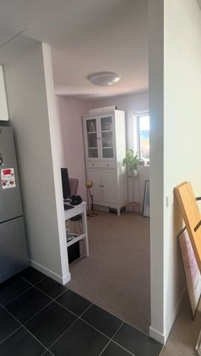

Hello. I would like to install a bi-fold door for my open study. The open space is 2400mm x 960mm, without any door frame. Is a bi-fold door a good idea? What parts would you recommend from Bunnings? I have some construction experience. However, I have never done a door before .

It's certainly a good idea to maximise the space and it sounds like your construction experience will hold you in good stead. The main consideration you'll have to make is that you'll have to make some alterations to the frame to install it.
As bifold doors operate on a top-hung rail system, you will need to alter the framing to add a bulkhead and jamb that supports the door.
As 2400x920 is a fairly large size for the opening, you will have to either order a custom door, such as the BF29 Humecraft Bi-Fold Door, or reduce the size of the opening considerably to accommodate an off-the-shelf size.
If you're looking for a low-cost, lightweight door, you can also check out the Pillar 82 x 203cm White Monaco PVC Concertina Door, but once again you will need to alter the framing to suit the size of the door.
If you advise the depth of the opening, which I have marked below, I can recommend materials for altering the opening.
Allow me to tag @Dave-1, @Nailbag and @JoeAzza for their thoughts and advice.

I havnt installed a bifold door but thinking through the steps and the change of framing (you will need to mount whatever door you choose to timber with no plaster between it and the new door) It is doable but you will end up with a smaller opening. I do like the idea of the height that you have. I think it would be a nice look to frame up the door sides and install those tall doors.
I had a hand for the first few doors that I hung (well it was my carpenter mate really :smile: ) and I was nervous, I knew the steps but did not have the confidence. If you follow the steps that @JacobZ has outlined with the framing it should be an easy enough job.
I thought to offer a barn door styled door instead, maybe on the inside as the fridge looks like it will be too close to allow a door to slide open.

When installing the jamb, the opening will be reduced by 19mm on each side, reducing the width of the opening to 922mm, which is pretty much a perfect fit for the rail.
