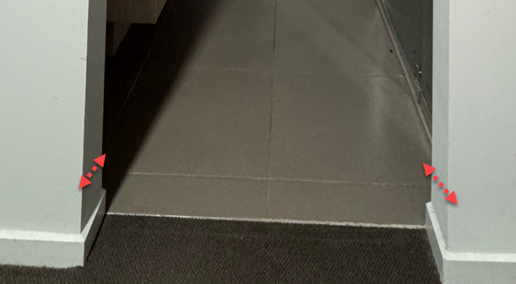

I would like to install a door in the washroom attached to the master bedroom. The dimensions where I want to install door are 2360*770mm. Can you please suggest which size door and frame would fit the space.

I'm also going to need to know the depth of the door opening as the material you will use for the jamb is relative to this measurement.
With typical door openings, you would use either 92 x 18mm or 112 x 18mm to build out the door jamb. This accounts for the different-sized framing that is typically used. Check out How To Install a Door Jamb for some guidance on the process.
With an opening of your size, you would need to use a Hume 2340 x 720 x 35mm Internal Door
