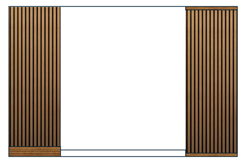

In keeping with a clean line and maximising the look of the panels, I would cut the skirting the width of each panel. Then either insert a stained matched timber board on the bottom or smaller ones top and bottom. The height of the inset boards would 160mm to fill the gap perfectly. Personally I would go the top and bottom version. Image below shows a sample of each.
Nailbag
