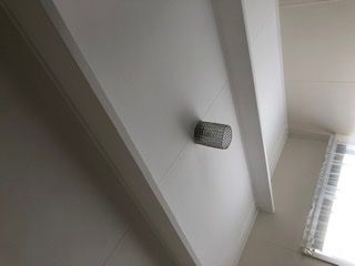

  • We have got exposed beams as seen in the attached photo. How does one plaster around those?

How about around the exposed beams? Do I need to put a timber moulding like it is now or can it be square set without it?

As to the exposed beams, I'm afraid you'll still need to use timber moulding as liquid gap fillers will droop when applied on a horizontal surface.
