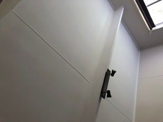

That’s great, I’ll go check other profiles out in store later this week. I’m sure I’ll find something. Is there supposed to be a gap between ceiling and wall sheets or can it be flush?

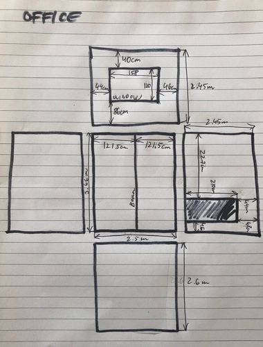

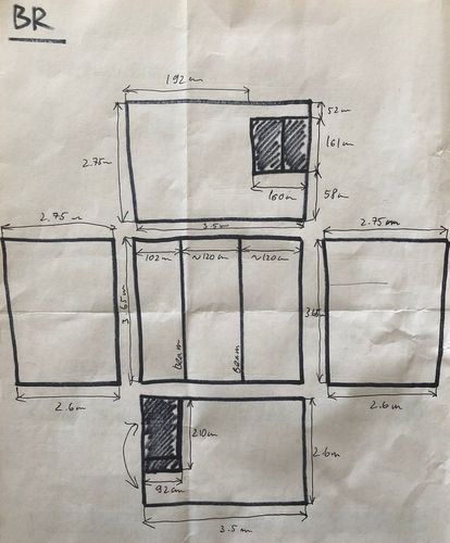

Getting ready to order plasterboard and trying to figure out what sizes. I understand that bigger sheets are better to minimise number of joins one has to patch but due to access issues to both of the rooms I won’t be able to get in bigger than 2.4. Maybe 2.7 but probably 2.4 to be in the safe size. Would you be able to recommend the correct address size and number of sheets I need to order? I’ve attached rooms measurements. Thanks!!!’

Typically, plaster sheets are laid horizontally. For the office, you'll need two Gyprock CSR 2400 x 1200 x 10mm 2.88sqm Plasterboard RE per wall and two Gyprock CSR 2400 x 1200 x 13mm 2.88sqm Plasterboard RE for the ceiling and then an extra sheet of the 10 and 13mm to fill in the additional gaps. For the bedroom, you'll need the same, but a bit more extra to fill gaps as the room is larger. So, as a rough estimate, I'd suggest 18 of the 10mm sheets and around six of the 13mm sheets. That should get you pretty close to the mark.

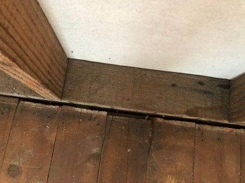

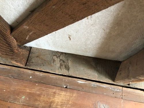

I will also have to have a carpenter assess the condition of the framing as it is rotten in few places (especially below a window that had a leak). In the meantime I am thinking how to fix these gaps in the floor:
They are where the floor meets the wall frame and they are quite big - 1-2cm in some places. You can actually see into the garage below! Do you have any suggestion how to seal these gaps?

The gap will be sealed by the plaster width and then the skirting boards width
Freaky I know! When I removed my skirting boards in preperation of having the floorboards sanded I couldnt believe how much of a breeze came through. Once I replaced the skirting boards all was fine, no breeze and no access from below for any four legged friends
I could actually see the light I had left on downstairs when the boards were removed!

In regards to the gap I would go with @Dave-1's recommendation. But if it is really bothering you, I suggest using Sika 850ml Sika Boom Expanding Foam. It will fill up any gap and it can be trimmed down with snap-off knife.
