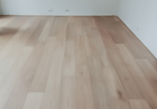

End result :

Did you have any photos of the finished floor that you'd be happy to share?
It'd be great to see the end product.
