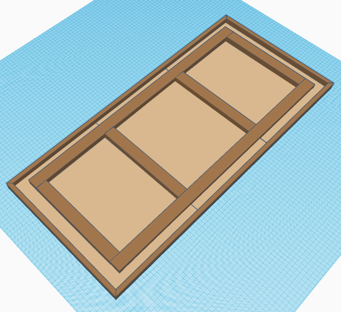

Hey legends! I have a fair few of these flooring samples that I thought instead of throwing out they’re perfect size to put together as a table top for a dining table! They’re heavy and pretty sure they’re wood as I have drilled through one before. I wanted to get some advice on the best way that I could stick three of these together length wise to create a table top! I already have side tables as the legs to stick. So I just need to figure out how I could put three of these together length wise as you will see they aren’t very thick. Also then wanted to maybe paint black or stain black?

They look like they'd make a great tabletop! Since they are so thin, I'd recommend creating a frame with something like 66 x 30mm Pine to support them. I've created a rendering below to illustrate. You can then add glue between the panels and also to the frame before screwing through the frame and up into the tabletop. Make sure to select screws that are slightly shorter than the combined thickness of the frame and top. Since you can see the MDF base layer on the edge of the panels, I suggest finishing the sides with timber beading to obscure them. Using a 30mm beading will give the illusion that the top is thicker than it is.

Thankyou so much for your help! Is there a way even to just get like a full panel of something and stick them on top of so I don’t have to do much cutting etc? Just thinking the cheapest and easiest way if you have any other ideas? Each panel is approx 900 x 600 and I think I might do 3!
Re: How to make a dining table out of samples
You could just glue them on top of an 1800 x 900mm 16mm MDF Panel @SarahK1996👍 Great thinking! I don't think it would be particularly noticeable if it did, but any large panel that is only supported at the ends can potentially bow in the middle. That's why my normal go-to would be a timber frame with a greater thickness.
Since that's such a simple option, I'd suggest you go that route, and then if it did bow, you could flatten it back out with weight and screw on some timber batons underneath to add more rigidity.
