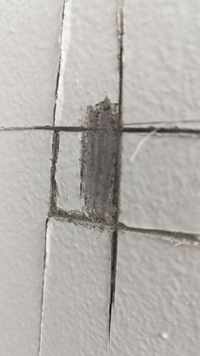

We are renovating our apartment and I'm looking to give the walls a bit of a refresh as they are currently quite bumpy and uneven.
I'm not sure of the material or finish of the walls but they are solid (not drywall) and I would guess painted cement render or lime render? The existing paint appears to have been applied directly to the cement/render and is not plastered.
Any suggestions for how to smooth the walls before painting? Hoping it won't be a full plaster job!
I've attached some photos of the wall showing unevenness and scraped away some of the existing paint to expose the render. (We are removing the wall I have scraped the paint off so no need to patch up).

That's a fairly typical level of finish for concrete walls in an apartment. I suspect plastering over the existing paint wouldn't be an option as it will fail to adhere adequately. The only option that comes to mind is having the walls ground or sanded back to a smooth finish. As you can imagine, that is a fairly intensive and dusty job that you'd want to enlist the services of a professional to do. Due to the safety implications of grinding concrete, I highly advise against conducting this work yourself.

No specifically designed paint for that purpose, @dstanley. However, if the stippled effect is from the texture of the concrete/render, then additional coats of paint will smooth it out to a certain extent. It might be worth doing a test section in an inconspicuous area. Apply three coats of standard wall paint, waiting for them to dry in between and see how well it disguises the texture.
No need to remove the paint before sanding. To reiterate, though, I'd only go down that route with professionals conducting the work; even then, it's a messy process, and the room would need to be cleared of all possessions. Please read this document on the hazards of crystalline silica and silicosis. These are very real dangers, and if the correct procedures are not adhered to, including suitable PPE and isolation of the areas, there's a significant risk to your health and those around you. I would put this job firmly in the basket of your dislike of the stippled effect simply doesn't warrant the risk to your health in removing it. It's best to call in the professionals.
