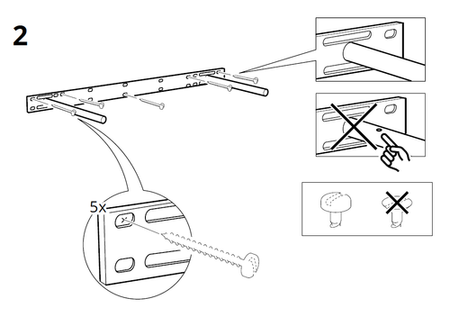

Here's the installation guide for the screws. The

For the floating shelves, the principles are very similar. The 15kg rating quoted by manufacturers is usually based on fixing into a solid masonry wall like concrete or brick. The shelf itself may be capable of that load, but the fixings into plasterboard or metal studs are the limiting factor. With metal studs, you can fix some of the bracket holes into the stud using fine-thread metal screws, and use heavy-duty plasterboard spring toggles for the remaining holes. That can work, but you need to be realistic about the load and not push it to the full stated capacity. For a floating shelf on plasterboard and metal studs, I’d be more conservative and keep the load well under that 15kg, especially if it’s being used for books.

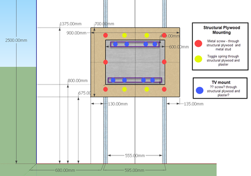

Thanks for that@MitchellMc.Looks like even with the right screws the mounting could have failed anyway, good that it failed now rather than later. The extra challenge here is the TV mount is a 'full motion' so the TV can be pulled to/from the wall and left/right. The TV is a 55 inch Toshiba (56U4750A) and is around 14kgs.
I've put the plan below.
  • I was thinking of using plywood that's 900H x 700W as the TV mounting bracket is 450H x 600W.
  • Use 6 metal screws to mount the plywood to the metal studs (3 per side/stud)
  • Use 4 heavy duty spring toggles to mount the plywood to plaster.
  • Use 8 screws to mount the TV mount bracket to the plywood (and maybe through plaster?).
Here's a copy of the plan if you want to make changes to the screw points.
The depth of the wall is around ~60mm (measuring from the plaster).
If the plan above is the way to go:
1. Which screws would you recommend for each (plywood to metal stud, plywood to plaster only, tv bracket to plywood)?
2. Which plywood would you recommend and the thickness of it? I'm guessing I can get the plywood cut to size at the shop?
