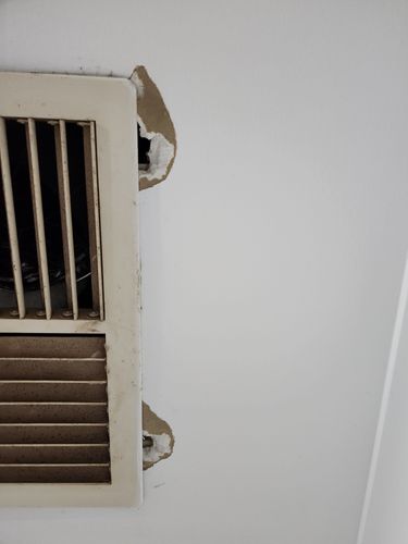

Hoping someone could provide some advice on the best way to patch these small breaks in the plaster at the edge of this vemr for my swampie.

You should start by removing the vent, so you have access in behind the plasterboard. You'll need to have some kind of backing that you can apply a plaster compound to. This Siniat 10 x 2400mm PVC Casing Bead Plaster Trim would likely be a good solution that can be slipped over the existing plasterboard with the long side of the trim in the ceiling cavity. This would also help to protect the edge of the board from further breakage in the future.
Once there is some backing, you can apply some Gyprock Multi-Purpose Joint Compound to the holes with a 100mm Joint Knife. Fully fill the holes and smooth them as best as you can while the compound is still wet. Allow the plaster to dry and then sand with a 120 Grit Angled Sanding Sponge to get a perfectly smooth surface.
Once sanded, paint the patches to match the ceiling around it.

The Casing Bead Plaster Trim is obviously too long, im assuming that cutting it won't be an issue?
I also already have some Spakfilla from patching small holes, would this be suitable to use or would i need to get the joint compound?

It's perfectly ok to cut the casing bead plaster, just remember to sand the finished ends so that it will look neat. If your Spakfilla is still nice and soft, it should be ok to use it to fill the holes in the plaster.
Here is a handy step-by-step guide: How To Repair A Hole In A Plaster Wall
