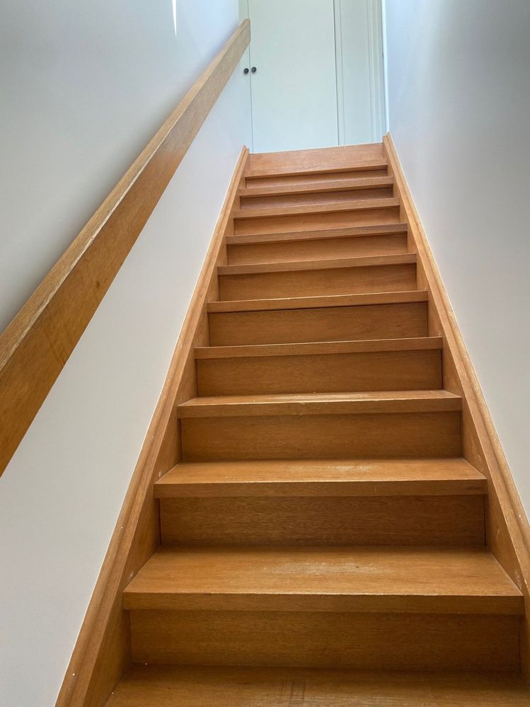

I'd like to give my staircase an overhaul and am after advice on which products and methods to use.

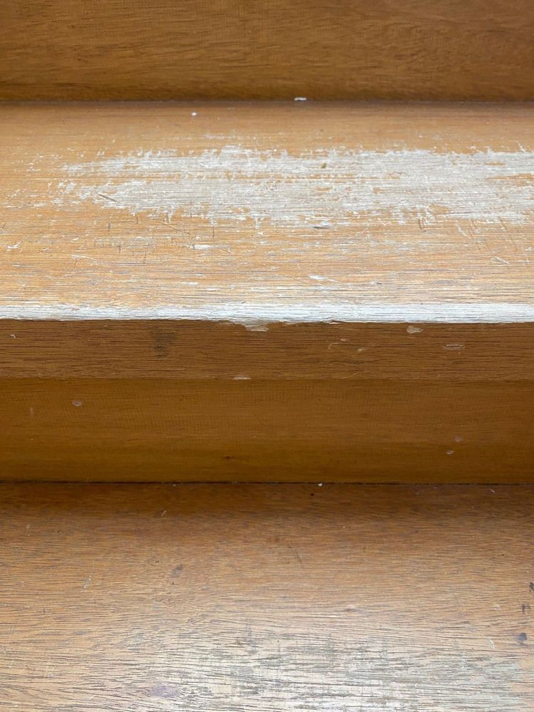

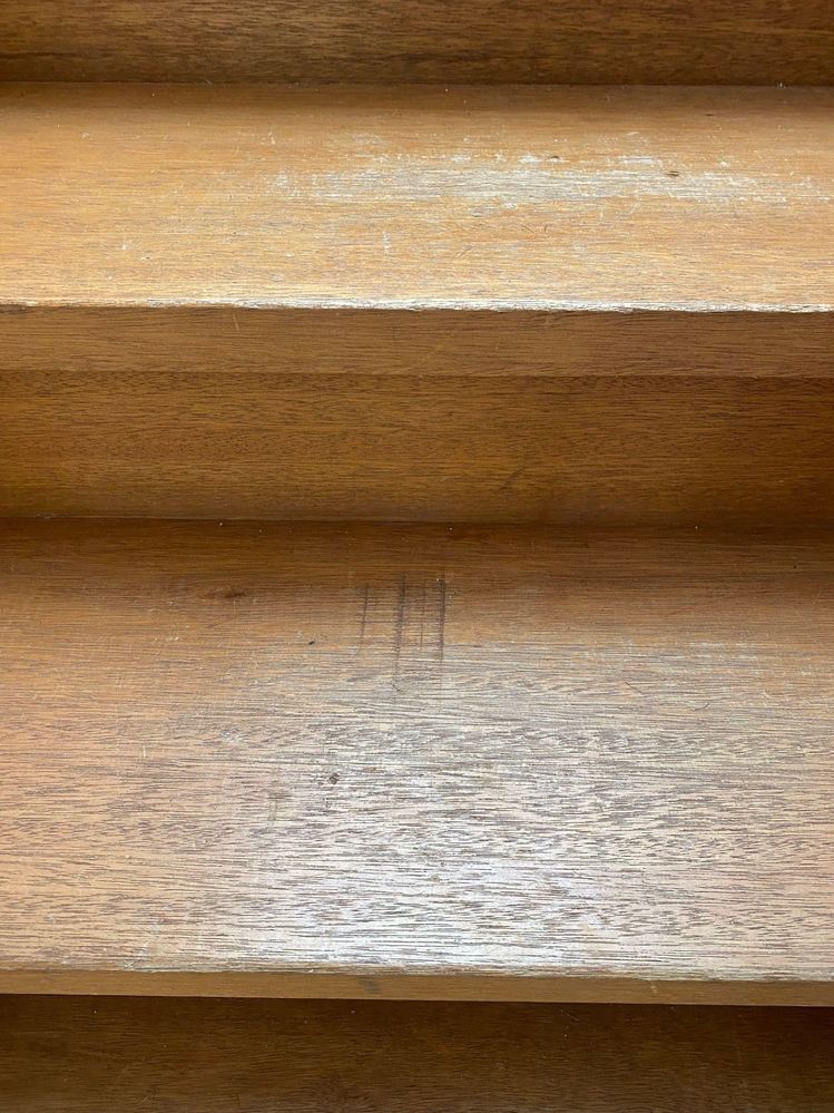

The staircase is wooden and not in the best condition (see photos). I'm thinking of either staining or painting it in a charcoal colour.
Which kind of paint would suit such a project best? For obvious reasons, it needs to be something that is anti-slip.
Other than filling gaps, sanding, and washing, will I need to do anything else to prepare the wooden surface for painting?
