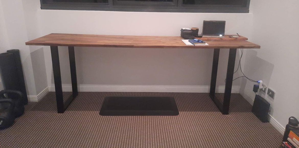

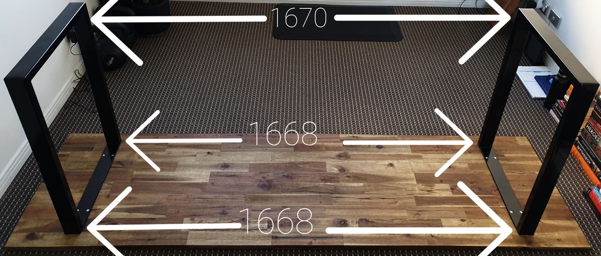

Built this desk today using 2200 x 600 x 26mm Acacia Solid Oiled Hardwood and 73.2 x 50 x 6cm Rapid Mesh Steel frame legs from Bunnings. I set the legs 200mm in from the ends and 50mm in from the sides. The table top is already bowing. The distance between legs at tabletop is 1668, the distance between legs at carpet is 1670.
Can anyone recommend a solution and material required to brace the tabletop from bowing and do I need to brace the steel frame legs at the top and bottom to make them the same distance?

If I had this issue, I'd fix the bowing by grabbing an additional Steel frame leg (or two) and place it either in the centre at the back (for one) or evenly spaced on the left & right at the back (for two). Would look a little weird, but it would fix the issue.
If you owned the home though, you could always create a brace along the edge of that back wall and secure the table to it, would just mean you can't move the desk as easily.

The bowing top has likely introduced the two-millimetre difference between the top and bottom of your legs, and you shouldn't need a brace for them. You can check this by flipping one leg around. If the distance remains the same, it's due to the top.

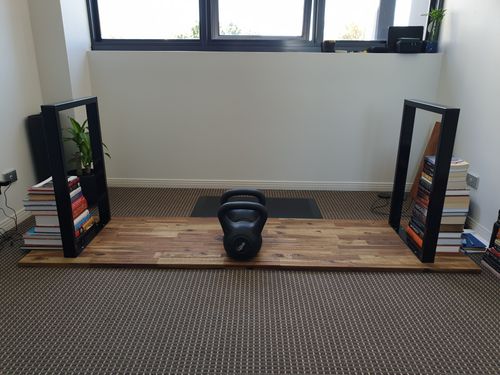

Will try flipping the tabletop and place books underneath. Thanks for the tip 👍

I'd recommend you flip the table, add the books on either end and place one of those kettle weights in the middle. Once it's returned to flat, you can flip it back upright and fix on your mid-leg. I suspect that the leg at the back will be enough to support the panel once acclimatised. If you experience further bowing, you could fix a length of 70 x 35mm Pine Framing Timber along the length of the table close to the front edge and spanning between the legs. Set it just far enough back from the front edge that it can't be seen from the front.

Awesome stuff @Bobnotabuilder , keen to see a picture of the desk once the installed the additional leg brace is installed. It being flipped like this would be a perfect time to install any cable management features to the underside as well.
If that doesn't entirely fix the issue, you can place a book under the top at either end, raising it slightly, @Bobnotabuilder. That will allow the top to bow slightly in the other direction. Don't allow it to bow too much in the other direction, or you'll run into the same issue. You just want to over-correct it slightly.
