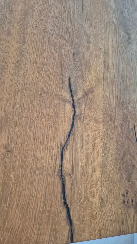

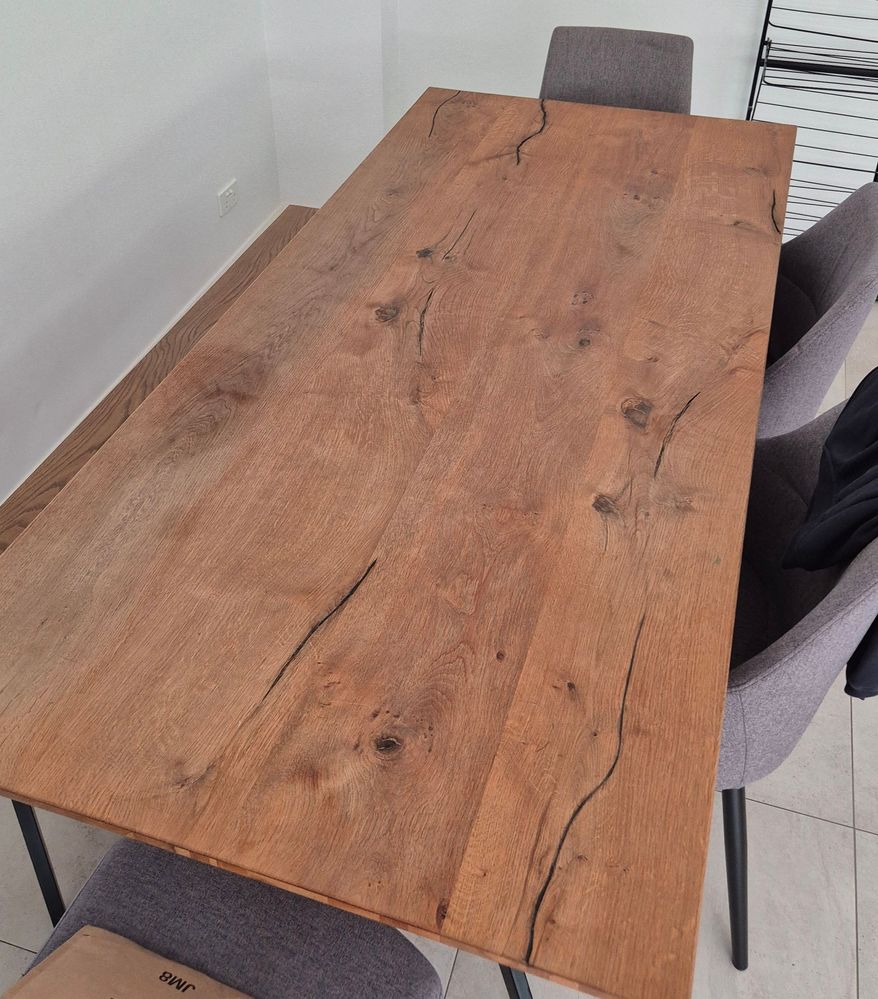

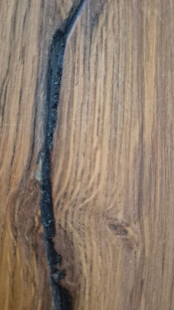

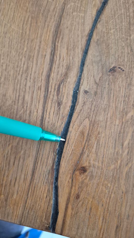

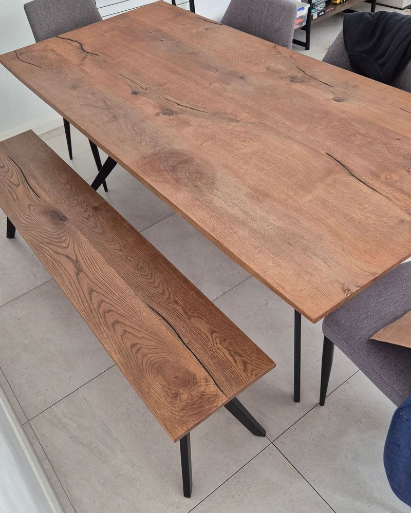

How to refinish dining table? I wanted also fill in the cracks in the table. I want to get kind of natural wood matt finish. Table size is 200cm x 90cm. How to do it? Which product I should choose?

The general steps are to sand the surface of the table, I recommend using an orbital sander in order to get a uniform finish. I recommend starting with a 180grit and finishing off with a 240grit sandpaper for a fine finish. I suggest using a sharp timber chisel to remove the sealer and debris in the timber cracks and gaps. I propose using Timbermate Wood filler in the shade of the timber of your table. Wipe the surface clean of sanding dust with a damp cloth and make sure that the table is totally dry before you begin painting your table.
