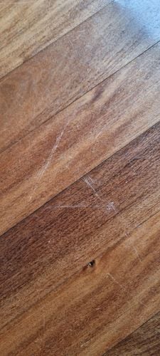

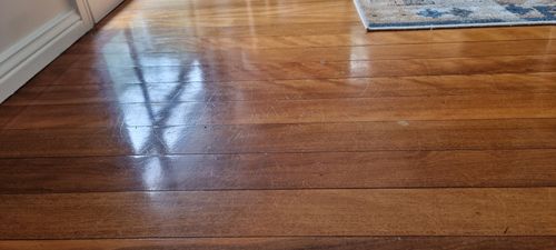

Hi Team,
Our wooden floor seems to have few areas of scraches while major area just seem to be fine but fine lines of movements are visible when looked in lights from another angle.
In such cases what are my options for repairs? I dont want to spend a lot of money.
Re: How to refresh timber floors with light scratches?
Hi @sjejani,
My suggestion is to use a floor polish such as this Cabot's Floor Polish, which is applied undiluted with a sponge mop.
It restores shine and reduces the appearance of scuff marks and scratches on timber floors, which is what your issues appear to be.
You'll want to ensure the floor is well cleaned before application of this product to ensure things like dirt and dust are not encapsulated in the polish.
Let me know what you think, and if you have further questions, please don't hesitate to ask.
