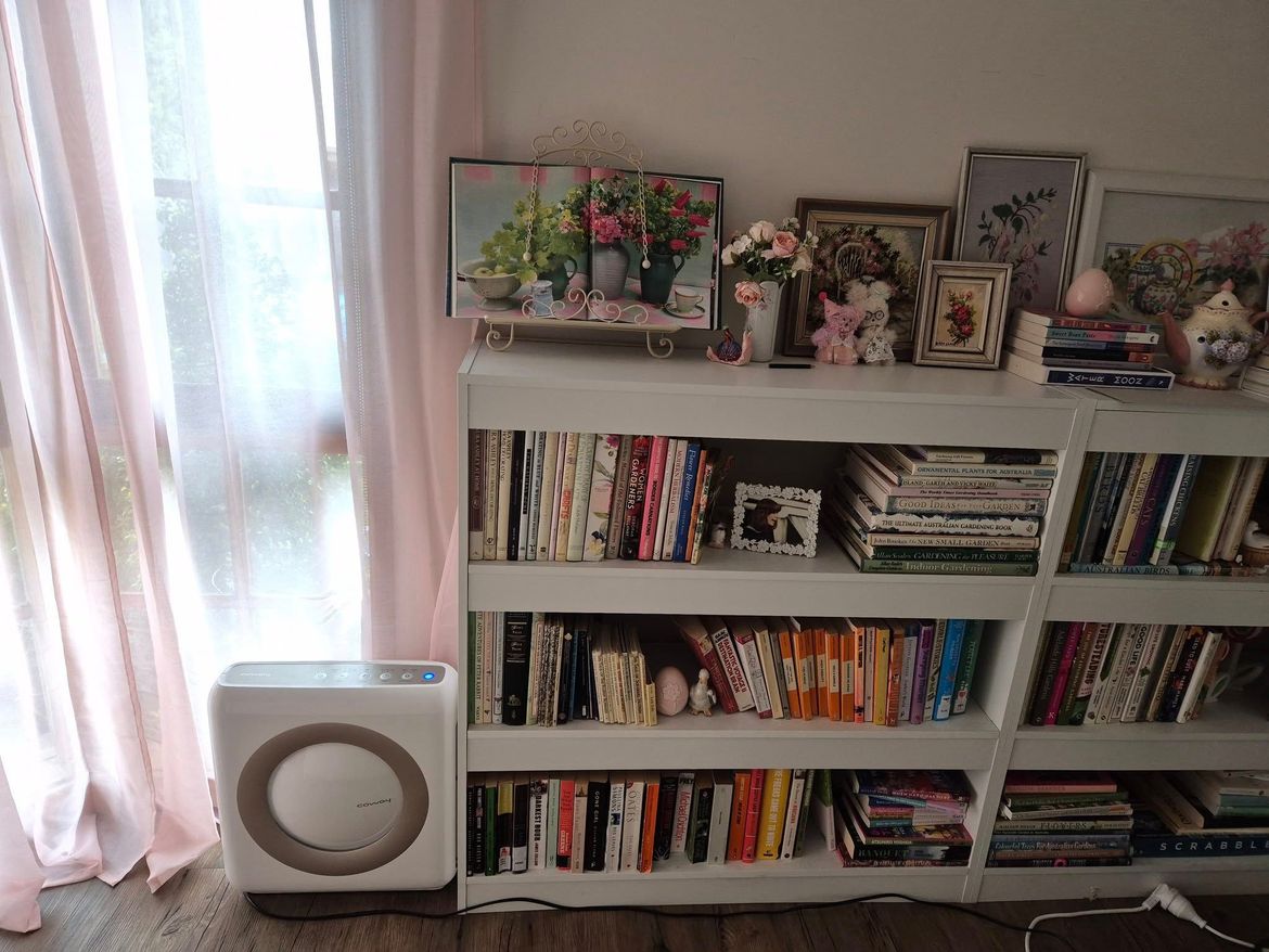

Even though the parts you are attaching to the bookcase are strong, the MDF material of the bookcase itself is not. Therefore, even with multiple supports the weakest link is the MDF itself. 100kgs is a lot of weight and is equivalent to three midsize toilets. I propose building a dedicated table to hold your fish tank, I suggest using 70x35 framing timber and Specrite 1200 x 405 x 18mm Timber Multi Use Pine Panel - Bunnings Australia.

Thanks for the response. I know the mdf itself isn't strong, which is why I'm wanting to make a reinforcing shelf underneath it. The existing mdf/shelf would effectively just be an aesthetic shell to cover the more utilitarian bracketed shelf.
Is mdf still a problem if layered onto a more durable timber plank (or timber framing)? Would it be less troublesome to entirely remove that mdf top piece and just use a plank on heavy duty brackets??

Ultimately, the bookcases aren't ideal, and it's hard to say for sure because I can't check the bookcase myself. A design like @EricL's, through the use of solid timber framing, would ensure it is properly supported, but I think it should be fine to keep the MDF with some additions to strengthen it. MDF is not weak, it just needs to be supported with hardware and framing to ensure the weight is distributed and supported.
Adding heavy-duty brackets that are screwed into the studs is a must. I would, however, suggest you try to maximise their length coming out from the wall to ensure the front edge of the shelf is well supported. These Carinya 250 x 200mm Black Angle Brackets, would be better suited.
You should also add a 70x35 ladder frame underneath the top shelf and screw through the side walls of the bookcase to connect this frame to the bookcases vertical support.
Something like this should work.
This design should be strong enough to support 100kg, but adding legs at the front edge would be ideal.
This would mean you'd have to notch out a space in each shelf to allow the legs to run through to the ground. This wouldn't be too difficult to do, but it would be a fair bit of extra work. You could then attach some white melamine to the front of these legs to conceal them.

I really like this idea! If I added legs at the back of the shelf as well could that eliminate the need for the brackets? I would still have one from the centre into the stud for additional support and stability.

Ive had a lot of fishtanks over a bunch of years. They have alwas sat on solid timber framed benches or stands, never particle board (Was rolling back through my memories lol)
I like @EricL's design to hold the tank, Other things to consider are external filters and such, water and particle board dont mix to well, and usually by the time we notice there is a leak from something then the particle board will be wet wet. Im not hugely keen on brackets holding weight such as a fishtank either.
Why not build a frame like the one @EricL has suggested but modify it so you can "clad" it so it looks like one of your existing bookshelves? It may take a little more working but the peace of mind your tank will be there and be there without cracks overnight is really worth it.
