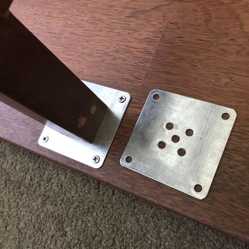

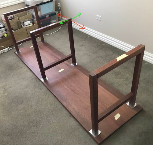

I have made my first every DIY table, with Merbau 220X60X2.6cm as tabletop, Merbau 4.2X4.2cm as legs, using metal mounting plate to mount legs into table top. I found a problem that when I hold the leg and attempt to move in the direction as in indicated by red arrow in the first photo, is feels a little bit wobbly. It feels steady when moving in the direction indicated by green arrow.

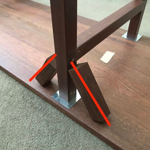

I suspect the cause is the mounting plate is not strong enough (it is 1.1mm thick). Appreciate if any suggestion I can reinforce it to make it more steady in the red arrow direction. If the suggestion is to use brackets, any specific models that are suitable and readily available to be purchased from Bunnings?
