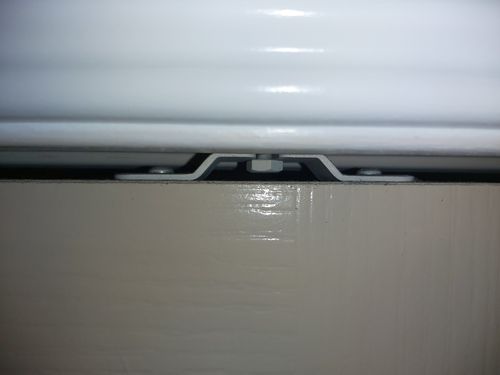

Hi all, I am wanting to remove my cavity sliding door so I can repaint it. I've removed the trims, I'm just unsure how go about removing the door with the hardware that is attached. Thanks.

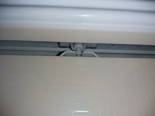

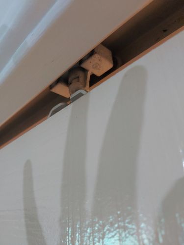

Thank you for the picture provided, it's a great help.
In the picture you will see the nut. Simply loosen this and it will give the door more room to lift up and down.
It should then easily slide off where the nut has been loosened.
If you are still having trouble after that please message back and the other community members will be glad to help.
All the best with it.
Kind regards Rob 👍

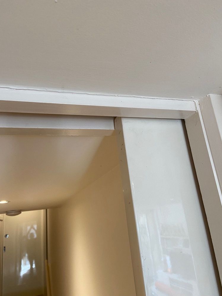

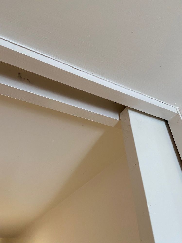

Hi Rob,
hope you can help with this cavity door problem. I need to remove the door to repair a broken roller wheel. However, instead of the usual pelmet that can be easily removed (I've done such jobs before), this door has 100x20 mm timbers recessed into the roof cavity. (see photos). Any ideas on how to tackle this job with minimal paster damage?

There is every chance that the assembly you have is similar to the first sliding door cavity at the start of this discussion. The first order of business is to be able to access the release mechanism of the sliding door cavity. Whoever built this went out of their way to cover the screw heads or nail heads holding the timber cover in place. I suggest using a magnet to see if you can locate the metal heads of the screws.
Once you locate them you'll need to break the putty seal hiding it using a screwdriver. However, if it is nailed in, I recommend hammering the piece of timber off. Once you have removed the timber covering piece you should be able to see the sliding door mechanism. But, if it is still too far deep in the ceiling cavity, I suggest stopping as this will require extensive removal of timber covers in order to access the sliding door mechanism.
I recommend engaging the services of a registered handyperson or tradesperson who can quote you the disassembly and at the same time modify it so that it can be easily accessed in the future. I've placed a video link below to give you an idea of what's involved with the installation of a modern cavity sliding door.
