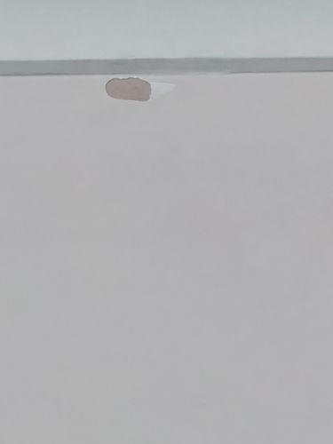

Hello my helpful and awesome community ..need your help yet again …so looking to paint a wall in the living area but the the way the previous owners did the painting ,the paint flakes every time we stick something to the wall and remove it (I mostly use 3m products and the one in the picture happened using 3m masking tape)
I don’t think it’s right to paint the wall with the previous coat of paint being in this condition ..how can I resolve this ?

I would suggest the reason for the flaking is that the wall wasn't adequately primed before application of the paint.
The only way to truly fix the issue as a whole, is to take the wall back to a bare surface. This could be achieved by using a suitable paint scraper and scraping it back to a bare plasterboard surface, or by cutting out and replacing the plasterboard.
Once back to a bare surface, you would need to apply an undercoat before applying your chosen paint.
You might like to check out How to paint like a professional for some guidance on how to get the best result possible.
I understand that this is a lot of effort to fix the issue, but it is the only real way to completely fix the problem. If you didn't want to go to this effort, you might want to use non adhesive fixings for anything you'd like to hang from the wall in future.
