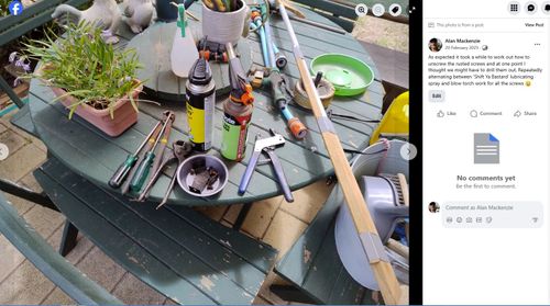

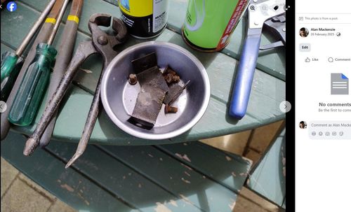

Here is one way.
Removing 'frozen' Philips head screws from framework.
Spray lubricant and butane torch.
I spray the screw area then heat with torch 1-2 seconds.
There will be a bit of gentle burn-off for a few seconds and while that's happening I get ready with the screwdriver to remove.
No issues removing all of them and when I finished that bowl was full of screws with brackets.
