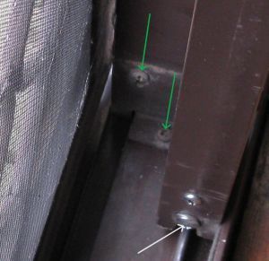

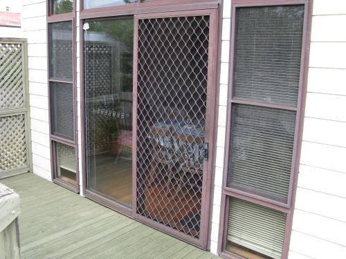

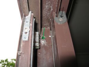

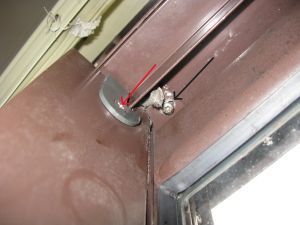

A version of Wunderlich sliding doors (wunderlich shown on the door handle) requires that the fixed panel be removed first. The pictures show how the fixed panel is secured. The second picture with the door shut shows the inside security screw (black arrow) holding the upper fixed panel bracket. The next picture shows the (green arrow) other screw holding the upper bracket. Next is the lower bracket (green arrow) holding screws. The fixed panel is slid towards the center and raised to clear the track and tilted out from the bottom. With the fixed panel removed the door can be removed by lifting and pulling the bottom out. The new roller units are not inserted into the door from the bottom but are slid in to the bottom rail from the end and to do this the bottom rail should be eased away from the glass slightly after removing the required screws. More details at www.poppasplace.auwunderlich sliding doorwunderlich sliding doorblack arrow remove screwblack arrow remove screwgreen arrow remove screwgreen arrow remove screwremove green arrow screwsremove green arrow screws
