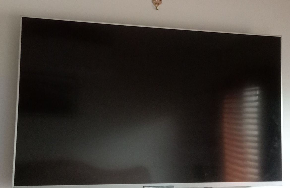

I have unplugged everything prior to attempting to remove this television from the bracket.

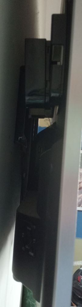

It slides left and right along the bracket but I actually have no idea how to remove the television off the bracket itself?
It seems to be screwed into the bracket from the back of the television. The space between the bracket and television is quite small and it is hard to see what might be happening.

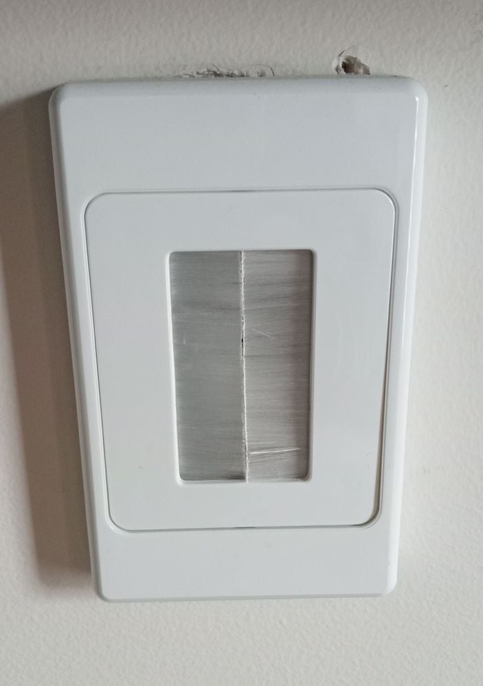

There is all something just below the television itself. It is surrounded by a plastic protective case and is like soft little brushes. I have no idea what it is nor its use. Id like to know what it is?

Hi @Innov8tive,
Televisions are generally attached to wall brackets in a way that allows them to slide into place and then lock so they don’t accidentally fall off. Most mounts work by hooking the TV’s bracket arms over the wall plate and then securing them with some form of locking mechanism. This could be a screw, a small lever, or a tab that clips into position. You’ll usually need to check carefully from the sides or underneath the television to spot how it’s held in place. In some cases, tilting the bottom of the TV forward slightly before lifting up can help release it. If the locking mechanism is engaged, you’ll need to undo it before the TV will lift off cleanly.
If you’re unsure, the easiest way to confirm the correct removal method is to look up the TV manual to see if the bracket was included with it, as it will explain the exact type of lock used.
As for the soft brushes you’ve noticed, that’s part of a cable management system designed to hide and duct the cords up behind the plaster.

Ok I got it. I will need to look into all this. As for the littile soft brushes encased by that plastic case, I now know wat it is so will just leave that.
Re: How to remove this television off the bracket?
I managed to remove the tv from the bracket. Need to pull down firmly on the straps, tilt TV forward, then lift up to remove from the bracket. Issue is I don't have the right tools to remove the bolts from the bracket on the wall. One thing I find a bit annoying is going to Bunnings and not picking the right size. I have a socket set but not the right size. I thought that since there is a lot og renos to be done it might pay to get a spanner set that has all the sizes I may need. I'm just not sure if a spanner set or a socket set would be better. Sometimes bolts are so tight or not screwed in on a straight angle which can make them harder to remove. I'm still even one bolt away from removing the bracket above the fireplace because it's just really stubborn. Even WD40 hasn't helped.
