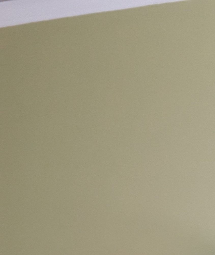

a loungeroom green feature wall
a spareroom mango feature wall
a bedroom all walls in the same green (photo attached)
All these rooms have abundant natural light.

1) Do I apply 2 UltraAir Dulux Primer undercoats and 2 top coats Dulux Interior Walls to make sure there's a colour match with the existing white walls?
2) Or 1 UltraAir Dulux Primer undercoat and as many coats of Dulux UltraAir Interior Walls as I need to ensure matching white walls?
ALL-GREEN BEDROOM
3) Given all walls are green, how many coats of Dulux Primer and Dulux Interior Walls should I use to achieve Natural White?
Both the green and the mango colours are a 'medium density' colour I would say. Not like a deep rich burgundy for example.
Thanks for your assistance, much appreciated!

Hello @LivMitch
Thanks for sharing your question about repainting your coloured feature wall. The general sequence is to apply a minimum of two coats of the UltraAir Interior Primer. The purpose of the primer is to neutralize the colour of the wall and bring it back to a neutral white so that the colour tone of the old paint will not travel through.
It is sometimes necessary to apply a third coat if the old colour is so dark that you can still see a hint of its colour coming through the primer.
I also suggest putting on two coats of the Dulux UltraAir Interior Walls so that you get full coverage and get the Natural white colour tone you are after.
