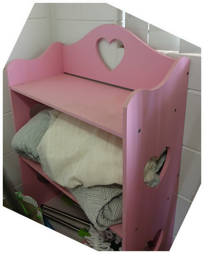

Hi my daughter has this pink bookshelf and now she id a bit older she would love to change the colour and its looking a bit old and worn...how do I do this? Do I need to sand, prep, undercoat, paint, top coat? Or am I better off wrapping straight over the top? Or spray paint etc?
Re: How to repaint kids bookshelf?
Hi @sedel2007,
As the bookcases' existing paint looks to be in fair condition, and paint will stick well to other paint, it should be relatively easy to paint over it with a new colour. There's no need to remove the old paint, just clean and scuff it up a bit.
I would simply clean it with sugar soap, give it a very light sand with some 180 Grit Sandpaper, brush it down to remove any sawdust and then paint over it with 2 coats of an enamel paint.
You can use a paint roller for the majority of the surfaces and a high-quality sash cutter brush for the internal corners and intricate areas.
