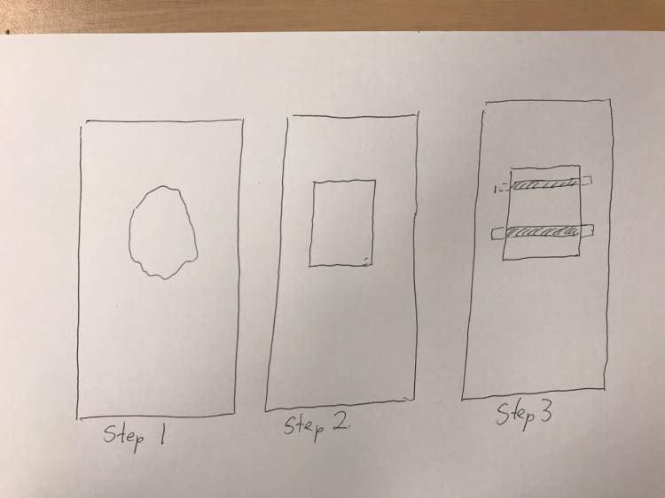

Step 1 is a large hole in a wall, Instea dof trying to cut to fit the hole. Cut the hole into a square or rectangle depending how big it is.
Step 2 is to give an example of what I mean.
Step 3 The two horizontal pieces are thin timber strips, longer then the holes width. These are glued to the backside of the plaster sheet (Various ways you can do that but I used liquid nails and it worked perfectly.

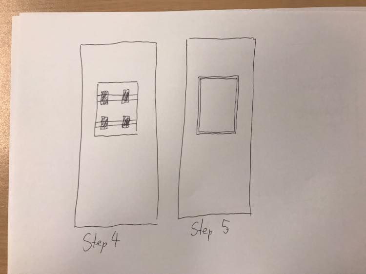

Step 4 You now have your square/rectangle cut hole, you have also glued a couple of timber slats across the hole (If you find timber post behind the hole even better) The 4 of tiny squares are spaces that together with the plaster you have make up the height of the existing plaster. So the plaster you have is 10mm thick, the old plaster is 13mm thick, that means your spacers need to be 2-3mm thick. I would suggest to look in the shims/spacer isle but this is the type of deal 75*100 by 3mm thick spacer. and glue them to the two timber rails. This gives you something to glue your new sheet of plaster onto.
Step 5 Now it becomes a standard hole to fix, Plaster, tape and a large flat spatula plus sandpaper and you will be able to have a smooth wall again ![]()
