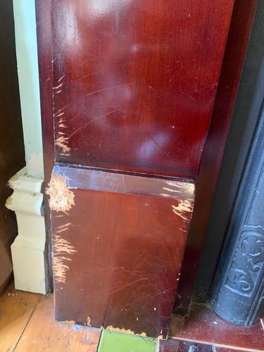

This wooden fireplace was damaged by a teething puppy. Looking for ideas - how repair and match the stain/taint (have been unsuccessful chipping off a piece to colour match).
Any recommendations welcome.
Welcome to the Bunnings Workshop community @oliviamay. It's brilliant to have you join us, and many thanks for your question about repairing and staining timber.
As you've found out, it's not possible to colour-match stained timber as it is not one solid colour. The colour match must be done by eye, and the closest available stain needs to be chosen. Unfortunately, it's hard enough to determine the correct stain even when you have the exact same original timber, and that's because the available stains will look different on the sample versus your timber. Further, you won't be trying to find a colour match for the stain on timber but, worse, timber putty. So the question would be, how do you stain the timber putty you've used to repair the section to match the existing stained timber? There is not really much chance of getting a perfect match, but you might be able to come close. A professional antique restorer would mix up their own stain and try many different variations to arrive at the best solution. The colour appears to have quite a bit of red undertones, so I suggest taking a look at Feast Watson stain and varnish in deep Jarrah or, potentially, Prooftint in Mahogany. The Mahogany might be a bit too purple.
You can use Timbermate 250g Pine Wood Filler to repair the damaged sections, and it will take a few applications allowing drying time in between to build up the missing corner.
I would suggest that this damage will always be noticeable, yet less so than it currently is. If you were looking for a close-to-perfect result, I would suggest enlisting the services of a professional antique restorer.

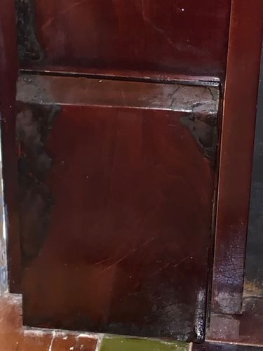

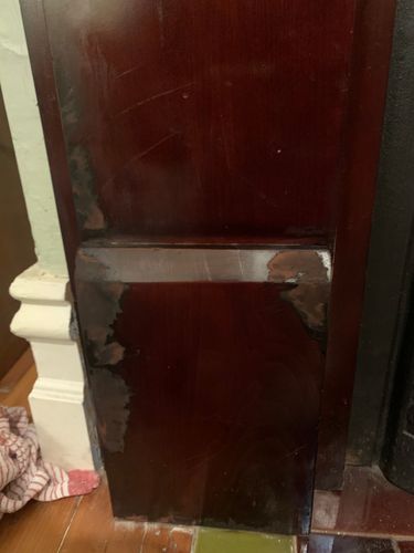

Hi both - gave it an attempt this weekend. See pics below.
Any tips for making it blend more? Thinking of trying the Feast Watson gloss clear varnish.

I like the work so far
Did you use the timbermate? Hopefully blending it in will go as nicely.

I just re-read your response. Are you going to paint over the putty? I would probarly do so before adding varnish as it could be pourus and will stand out with the varnish?
You've done a lovely job with that filler, @oliviamay!
The stained area is a little bit dark and lacks any colour variation. If you look at the original timber, you can see the grain of the timber and lights and darks. It might be worth slightly sanding the stain and putty to see if it lightens it up. Do you have any reddish acrylic craft paints that you could dry-brush the surface with to create some streaky wood grain effects? The other option is that you can take a craft paintbrush and apply some stain to it. Dab most of the stain off on a paper towel and then, with light strokes, spread the stain out from the repaired section onto the surrounding timber. This blends the transition and makes it harder to notice by eye.
I don't think varnish will improve the look, but it will lock it in.
