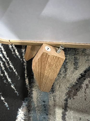

I have coffee table and one of the leg has been broken, need help to o fix this? Just fyi I am quite in diy stuff but happy to learn as more bigger stuff coming my way 😛

Could you please remove the damaged leg and take a photo of it? We need to see the upper part of the leg to understand the type of damage. There may be options to repair it, but our members need a clear view to determine whether it can be fixed or if a new leg needs to be made.
Also, could you take a photo of the entire underside of the table? This will help us assess how much the leg assembly has shifted in relation to the other legs.

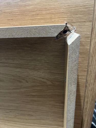

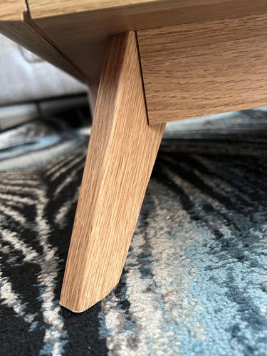

Hi Eric - thanks you so much for prompt response, actually leg is not broken it’s intact but seems like screw has broken coffee table wood and it is passing through it

Hello @kitkat20
Thank you very much for providing those extra photos of your coffee table leg. It appears that the leg was originally attached from the top and the leg has somehow been pulled through the tabletop. I suggest using Selleys 250g Liquid Nails Clear Construction Adhesive. I recommend making sure that the screw on the leg is tight, then squirt some liquid nails into the hole of the table. Put a small bead on the side pieces where the leg makes contact with the skirt of the table.
Use a clean rag to wipe off any excess that might overflow from the leg. I propose using a ratchet strap around the table skirt to keep everything together while the adhesive cures. Please make sure not to get any adhesive on the strap or it will get stuck to the table. Allow at least 24 hours before removing the strap.
Let me call on our experienced members @Dave-1, @Nailbag and @JoeAzza for their recommendations.

Good Morning @kitkat20
Thats a nice looking table and leg, I would also follow along the path that @EricL has described plus mabbe adding two little right angle brackets on the inside once the liquid nails has gone off.
Zenith 25mm Stainless Steel Angle Bracket - 4 Pack
Just to give that leg a little stability, I am not sure how much space you have on the inside either of the leg so taking a bit of a guess. I would use short screws so the point of the screw dosnt come up through your table top. The right angle bracket has around a 1mm thickness, the table top is ??mm so something 3mm at least shorter then that and screw in by hand, not a powered screwdriver.
