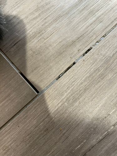

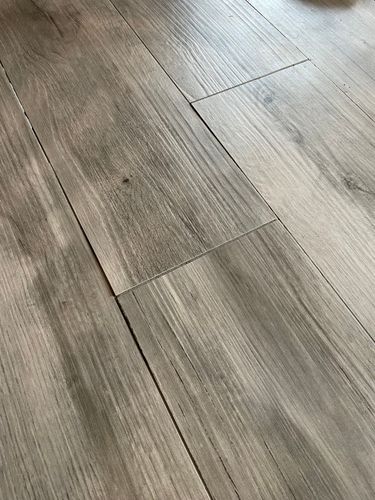

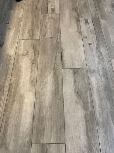

I've attached photos below
Typical tiles throughoutTypical tiles throughoutExample of raised tilesExample of raised tilesExample of chipped / missing groutExample of chipped / missing grout

Hello @lukec
Congratulations on purchasing a new house, I suggest using a multitool in combination with a Diablo 70mm Multi-Function Tool Ultimate Grout And Mortar Blade. This will expedite the grout removal and allow you to repair the area much faster. Please make sure to wear gloves, eye protection and a dust mask when using this tool.
Repairing the grout line is not enough to secure the tile to the floor. The tile must be cleaned off and the old adhesive on the floor must be removed so that you can re-attach the tile to the floor. If you are looking for a few years of extended service the tiles must be re-glued properly. Please note that if you don't have spare tiles, extreme care must be applied when removing the grout to prevent cracking the tiles.
I suggest using Dunlop 20kg Trade Resaflex it is a rubber-modified adhesive and is capable of absorbing substrate movement. So even if your floor moves the tiles will stay stuck to the floor. If the floor tile is still fully attached to the floor there is no need to remove it. I recommend mixing only what you need for the repair so that you'll not be wasting any adhesive.
I don't recommend doing a half-and-half repair of the grout line as the new grout will not adhere to the old grout. If that happens all that hard work you just did will have to be repeated. I recommend removing all the grout so that you can be sure that it has been laid in properly with no chance of grout failure.
