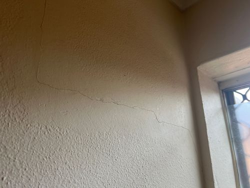

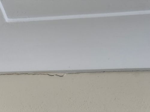

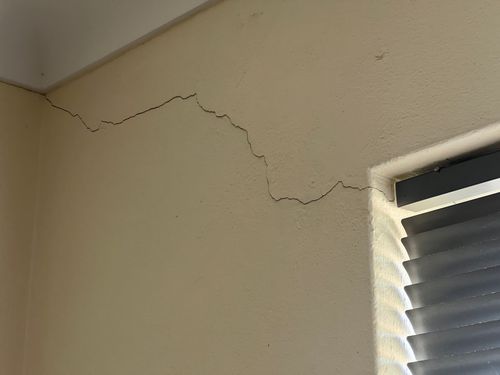

I’m stumped on a part though regarding the walls. The apartment has cement walls which have a stippled texture and I have the following issues:
How to fill the fine cracks

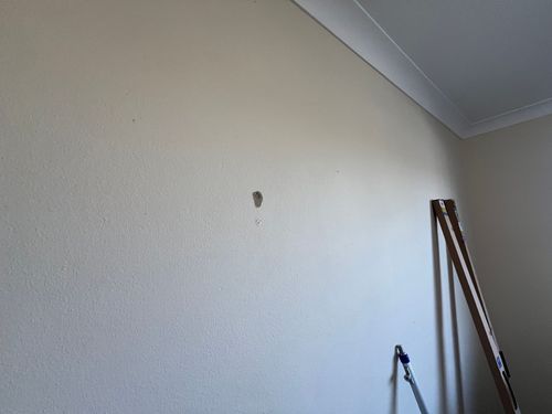

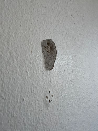

How to fill the small holes

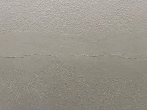

and lastly how to blend the areas that have been repaired in the past that are smooth and stand out. I will be painting with Taubmans Cradle White which is a warmer white minimising shadow from the texture if this helps.

For the fine cracks, I recommend using a product like Polyfilla 500g Exterior Brick and Render Masonry. It's ideal for filling small cracks and will create a render-like finish that blends well with stippled textures. To match the texture after applying the filler, you can gently tap the surface with an old toothbrush while the filler is still soft to recreate the stippled pattern.
For the small holes, the same product should work effectively. Make sure to press the filler into the holes and smooth it over before texturing the surface.
To match the existing stippled texture across the walls, especially for areas where the texture has worn down or been smoothed out, you could try using a UNi-PRO 230mm Medium Foam Texture Roller Cover, which will help to pull up peaks in the paint and give you a stippled effect. You may need to practice on a scrap piece of board or paper to get the right amount of texture and match it to the original wall.
If those areas are too prominent, another option is to lightly sand the surrounding textured areas to soften the contrast. This will help to blend both the smooth and textured sections before applying paint.
