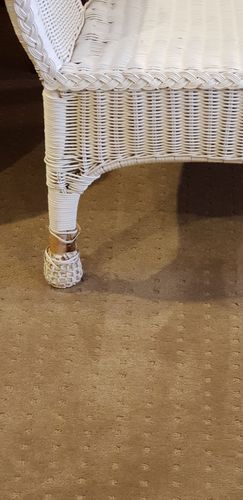

Hi I have a wicker chair where the cane binding has come off 1 of the legs. Can I buy the 5mm cane binding from Bunnings. Is this an easy project I could do?

This would be a reasonably easy repair to make once you get ahold of some wicker. Unfortunately, we don't stock any in our stores. Once you locate some, you'll need to secure the loose ends by passing them under the binds that are still in place. A small dot of super glue can help hold things in position. You'll then wrap your new cane binding down to the foot, following the other feet for reference. Once you get to the foot section, add a dot of super glue every few rotations to secure the binds. To finish under the foot, you might find they've used a staple to hold the end securely in place. I'm sure you'll find plenty of YouTube videos that illustrate this much better than my description.
I wonder if you could mimic the cane binding by using Grunt White Poly Core Clothesline? For it to be convincing, you'd need to cut the line down the middle, splitting it in half.
