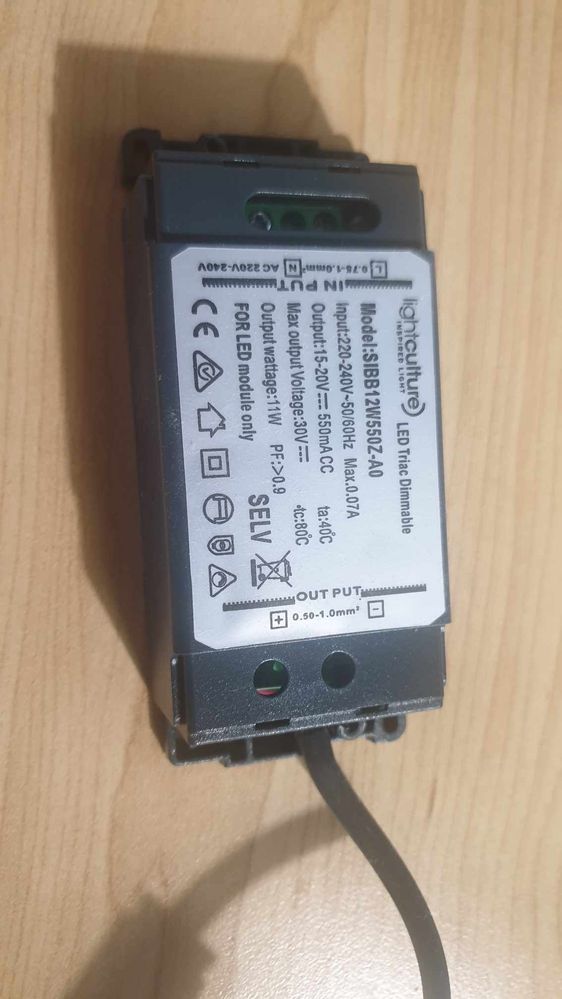

Hi team,
I'm trying to buy a replacement for the below.
Will you be able to provide me with advice on what to look out for when buying this?

Hi @dwerer,
We have the Deta 12V 15W Dimmable Electronic Transformer - For LED Globes, but your transformer outputs 15-20V. You'd likely need to speak with an electrician to determine whether this would be an appropriate transformer for your light. What globes are you running with it?

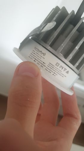

Hi team. Please find below globe. Let me know if you need any further information please
So these are one of those independent systems @Jewelleryrescue was mentioning that don't have a replacement globe. Typically, if the transformer or the globe blows, you need to replace them both. Because it's a proprietary system, you might struggle to find a replacement transformer. From our range, you'd need to take the globe into a store and have a look at our LED downlights to find the closest-looking system to replace it with.
Hi. I've tested the globe on a different outlet and it was working. So I think it might just be the transformer.
So should I try to replace the whole transformer that uses a typical light bulb? How difficult is this process?
I'd imagine @MitchellMc would be encouraging you to seek out a qualified electrician @dwerer. But unfortunately Mitch has had to take some unexpected leave. Let me tag some other experienced members: @MikeTNZ and @CSParnell to see if they can share their thoughts.
Hello @dwerer
It's great that you've made a determination of which part is damage. However, as MitchellMc has mentioned proprietary systems work best together. Using a third-party spare part will not carry any warranties with it and its performance will be unpredictable.
I suggest replacing the entire set so that you'll know that it will work properly and is covered with a warranty. Just a friendly reminder that any electrical work needs to be done by a registered electrician.
