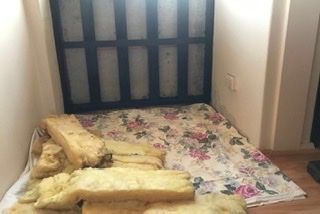

The tools and materials you'll need for the job are Craftright Retractable Knife With 3 Blades, Paslode 40 x 2.5mm 500g Gold Annular Plasterboard Nails 215 Pack, Uni-Pro 50mm Real Good Paint Scraper and Gyprock CSR 5.5kg Acrylic Stud Adhesive. For walls, 10mm is the correct size plasterboard to be using.
First, you'll need to take the measurements of the wall and transfer those onto the new sheet of plasterboard. Cut out the correct size piece to suit. After you have prepared the plasterboard, apply the Gyprock CSR 5.5kg Acrylic Stud Adhesive to the areas on the studs which I have marked in the image below. Once you have applied the stud adhesive place the plasterboard against the wall and use the Paslode 40 x 2.5mm 500g Gold Annular Plasterboard Nails 215 Pack to fasten it around the perimeter.

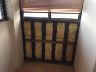

Thank you for your fully details and I want to replace the insulation too, what sort of insulation do I need and the wall only 1100mm x1000mm

A great product to use in this situation would be Bradford Gold High-Performance Wall Batts which can be cut to size and inserted between the timber studs. One pack should be plenty to fill that entire wall.

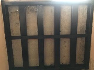

I found cracks on the outside wall, what sort of the board do I need to replace? the rails are made of metal so what sort of nails I should buy?

Hi @Maymay,
The board is most likely a cement-based wall cladding sheet similar to Hardieflex. I've spoken to a few companies and Timbermate believes their Earl's Multflex filler would be suitable to repair that crack. They suggest adding a drop of water to their product and using a spatula to fill the crack up. This product is great for cement-based substrates which may still flex over time.
For screws to go into the rails I would suggest using Zenith 10g x 40mm Gold Passivated Countersunk Head Metal Screws 50 Pack as they will self-drill and you won't need to pre-drill holes for them.
