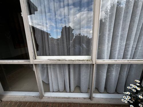

any tips how do I replace these rotten wood trims please? Not sure if they are called trims but its the wood next to glass. Thanks

Welcome to the Bunnings Workshop community @flummoxed01. It's wonderful to have you join us, and many thanks for your question about replacing a window frame.
How rotten is the timber and is the frame holding the glass compromised? If it's only a trim piece on the frame then it could be carefully pryed away and replaced. If the rot is not significant or structural in nature, then you could remove the degraded timber and use wood hardener on the remaining. You'd then apply putty to re-establish what timber was removed.
You must be exceptionally careful when working around glass, as one tool slip could cause it to shatter. Remember your PPE, including safety glasses, a long-sleeved shirt, trousers and enclosed footwear.
If there is structural damaged and rot to the frame, then I would encourage you to enlist the services of a professional to perform the repair and reconstruct the frame.

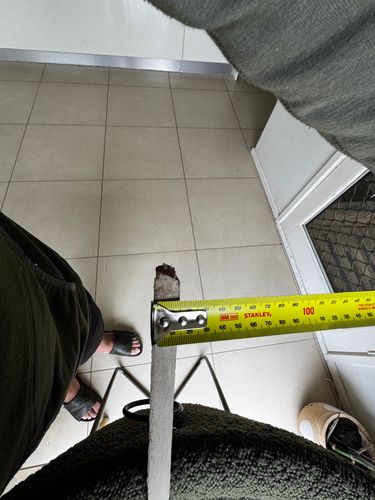

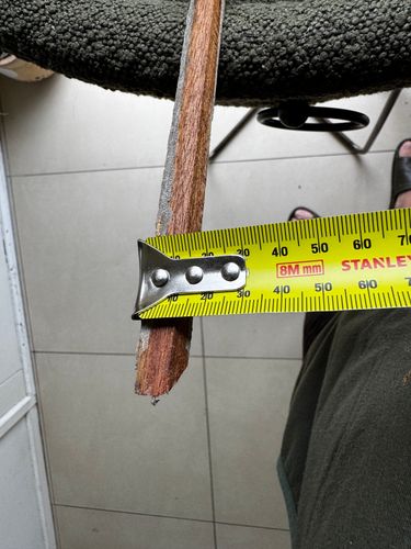

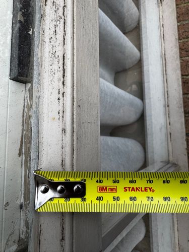

Its about 20mm- see photos pls. Thanks again

Hello @flummoxed01
Would it be possible for you to remove one of the trims? We need to see the profile of the timber moulding. For example, it closely resembles the 12 x 12mm 2.4m Tri Quad Clear Pine. But please take extreme care when lifting the trim as it is very close to the glass. Please remember to wear personal protection such as gloves, goggles and a mask when working on your window frame.

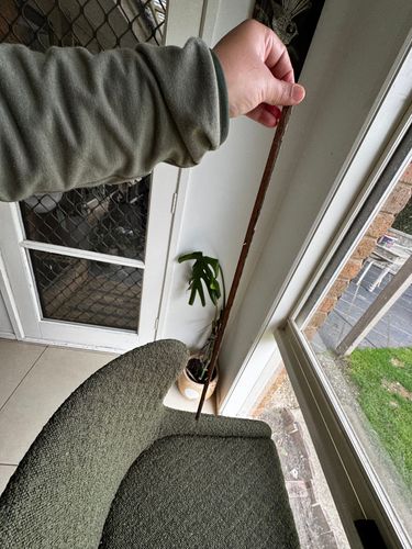

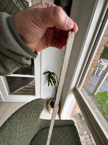

Hi Eric- see if this helps. The 11mm link doesnt work but will head into bunnings to see if I can find in store.
Re: How to replace rotten window trims?
Hello @flummoxed01
My apologies if the link did not work. I suggest just typing the description in the search bar 11 x 11mm 5.4m Moulding H3 Treated Pine FJ Quad Clear LOSP. But if you are on your way to the store, I also suggest speaking to the timber specialist so that they can make further suggestions regarding the timber moulding.
