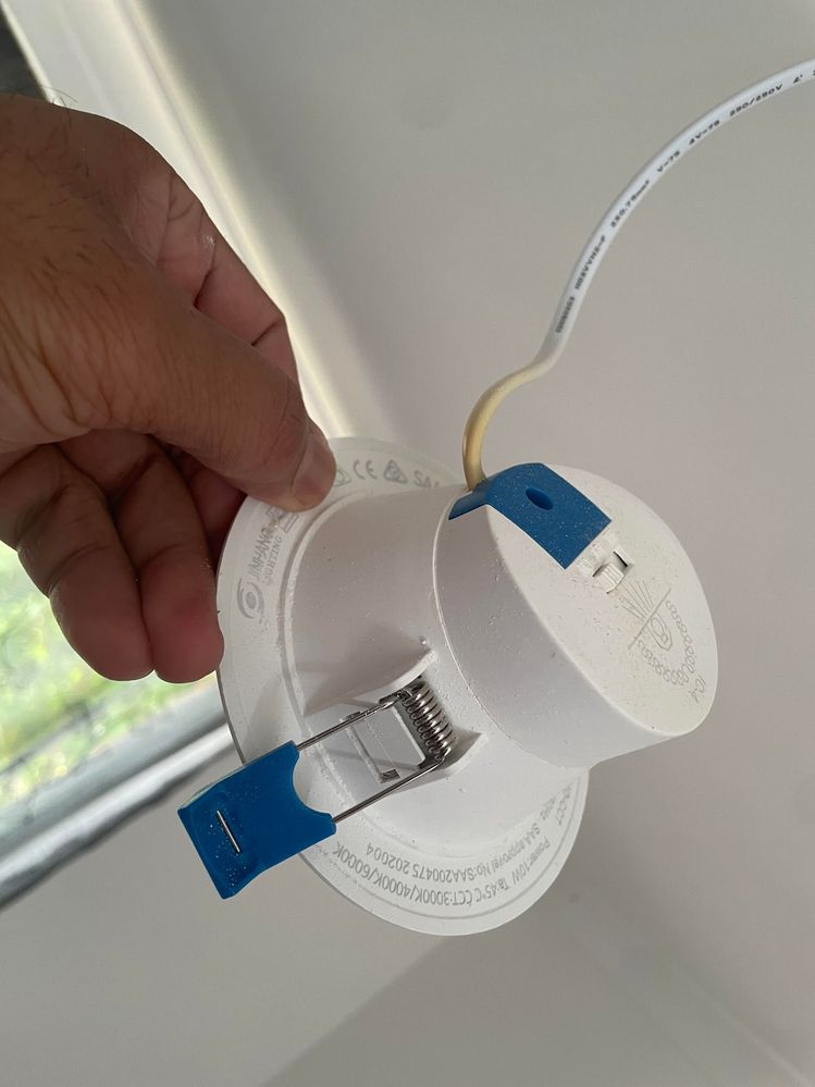

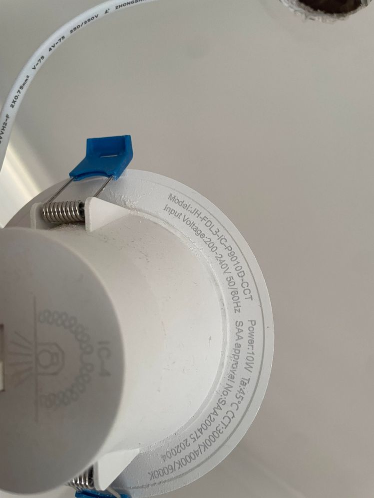

please see snips. Do you have a replacement for this ? it is the standard type - has a plug connected to the socket like you described above.
Hi @bm,
You'll need to check within your ceiling to discover whether there is a plug at the end of that cord. However, it appears this might be a hardwired unit, so I would advise contacting an electrician.
Something like the DETA 10W 940lm Grid Connect Smart LED Downlight will be a similar light and can be used as a replacement.
