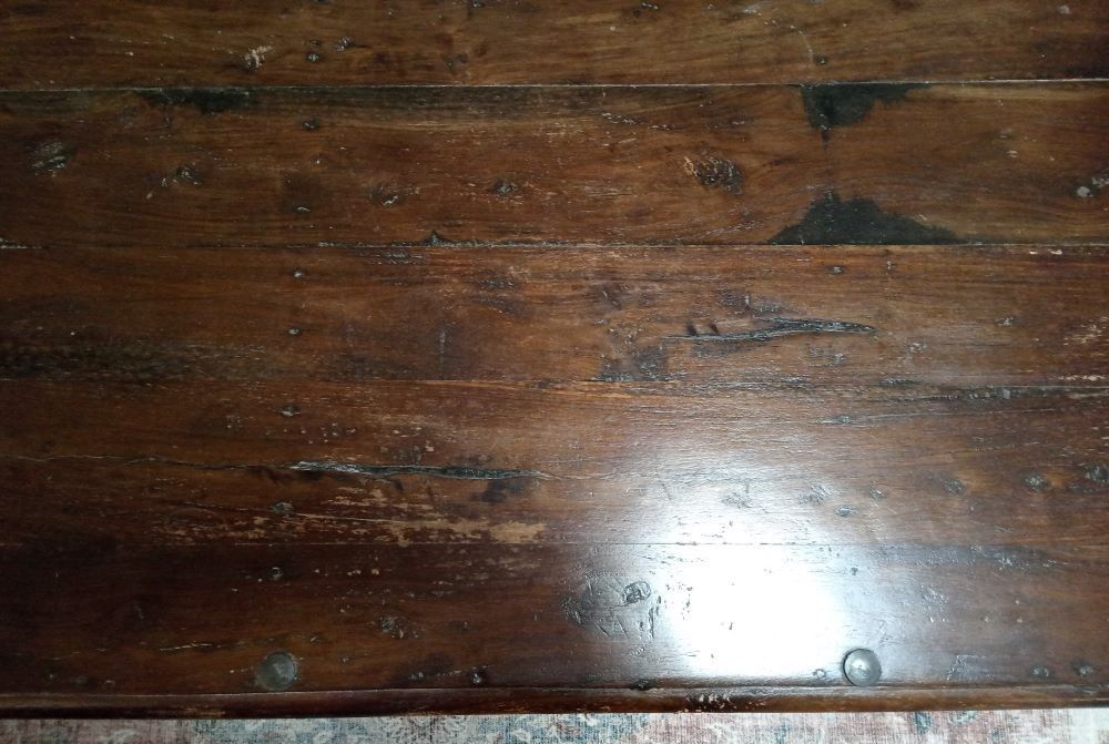

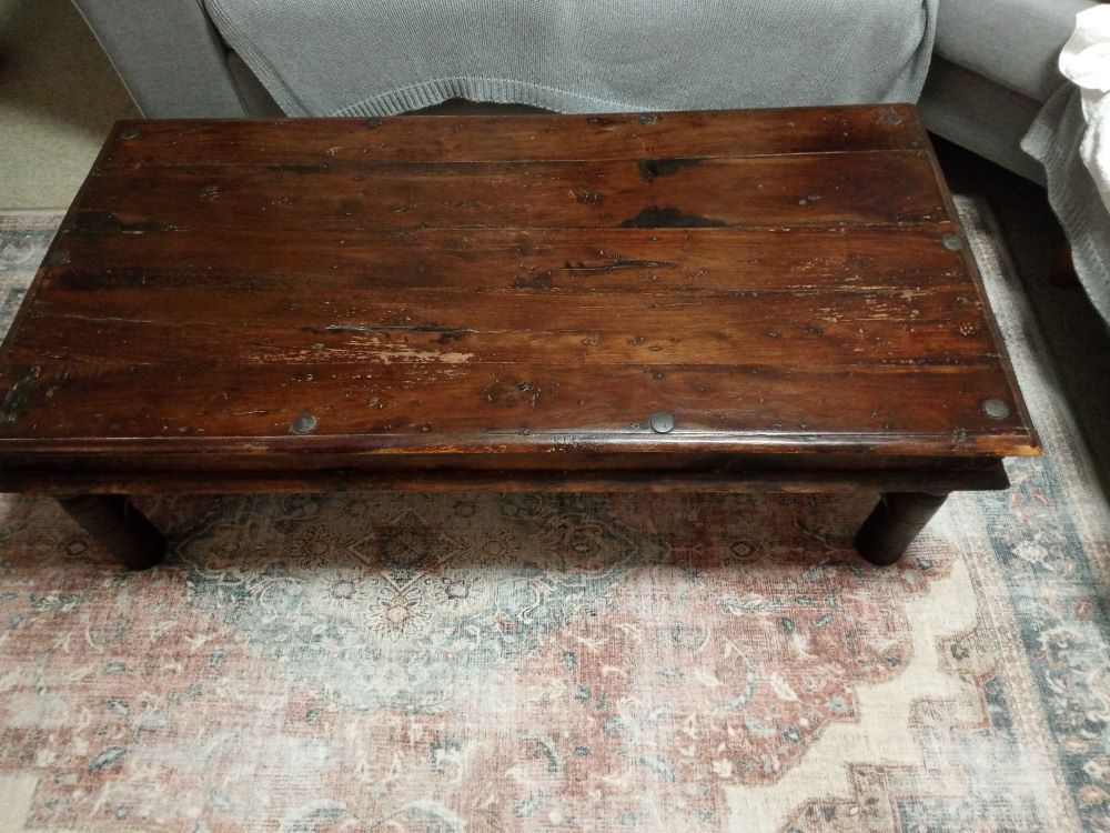

I own an old, rustic wooden coffee table - it's around 25 years old. When I first purchased it, it wasn't sealed or varnished and I sanded it then varnished it with a couple of coats of matte clear varnish.
I'd like to reapply some varnish, as it's wearing off in parts - I'd appreciate some advice on how to go about this, including what varnish to use. I do have some varnish on hand (Cabot's cabothane clear, hard wearing durable varnish) - is that appropriate? Would I need to sand it again? (I hate sanding with a passion but will obviously do it if necessary).

At the moment you can't get the full effect of the grain in your table because it's so dark.

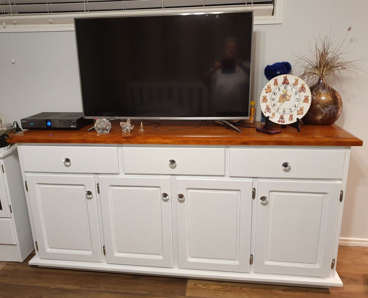

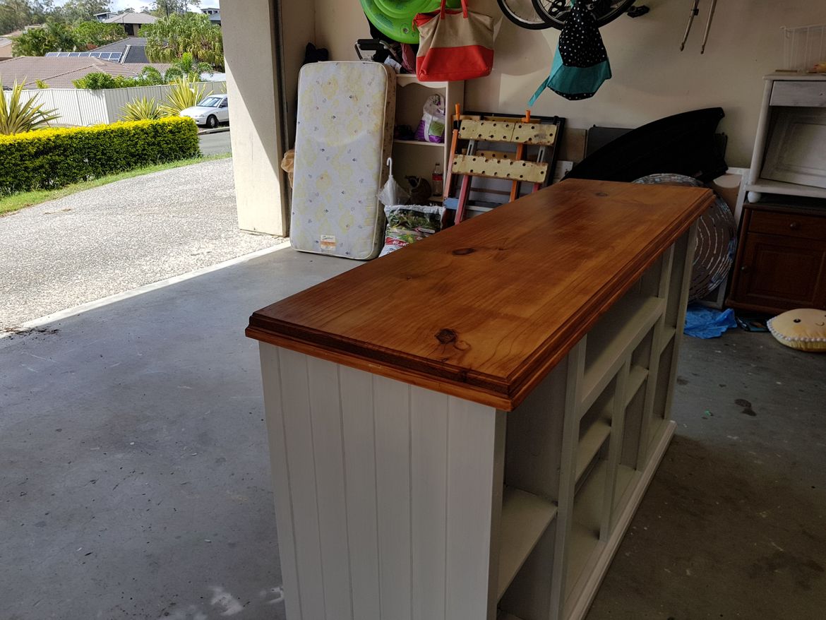

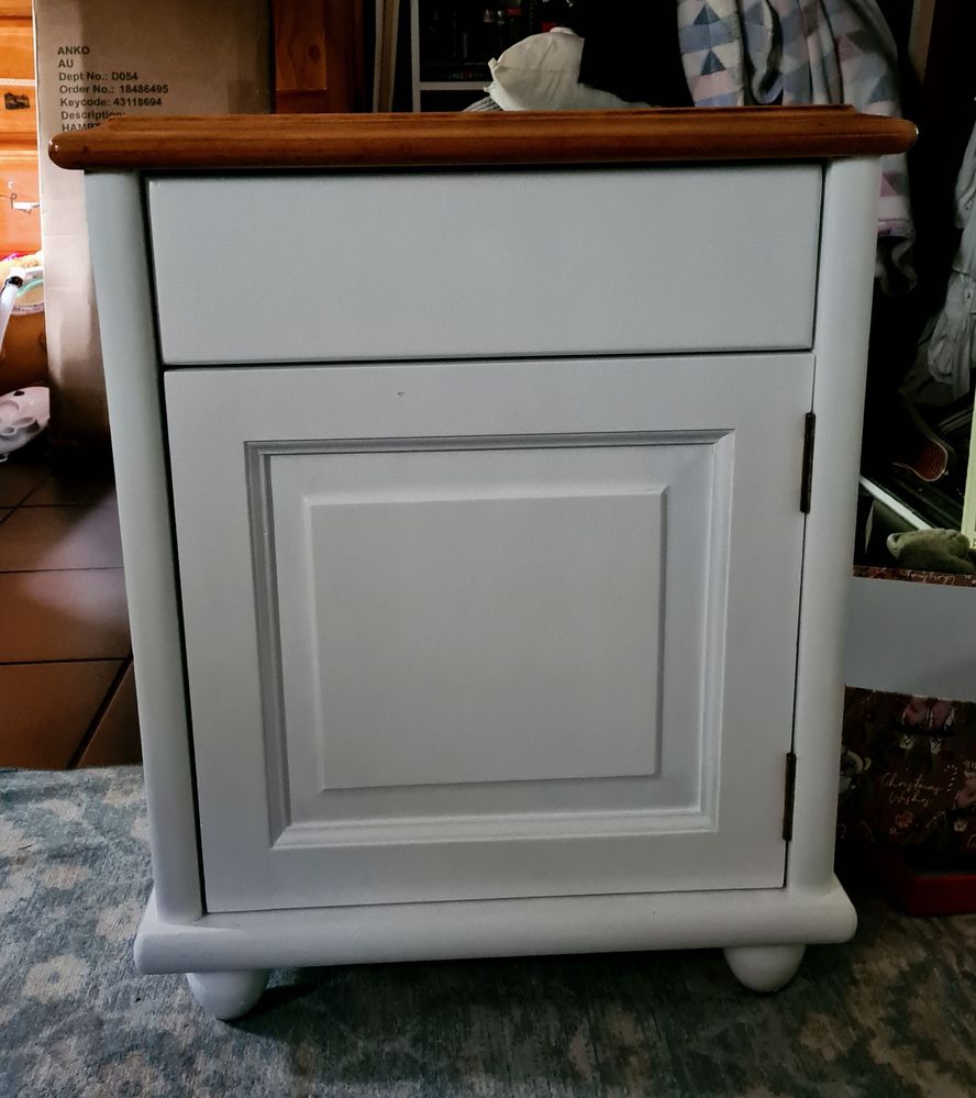

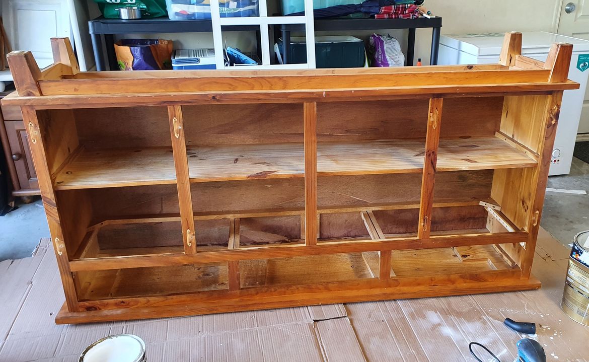

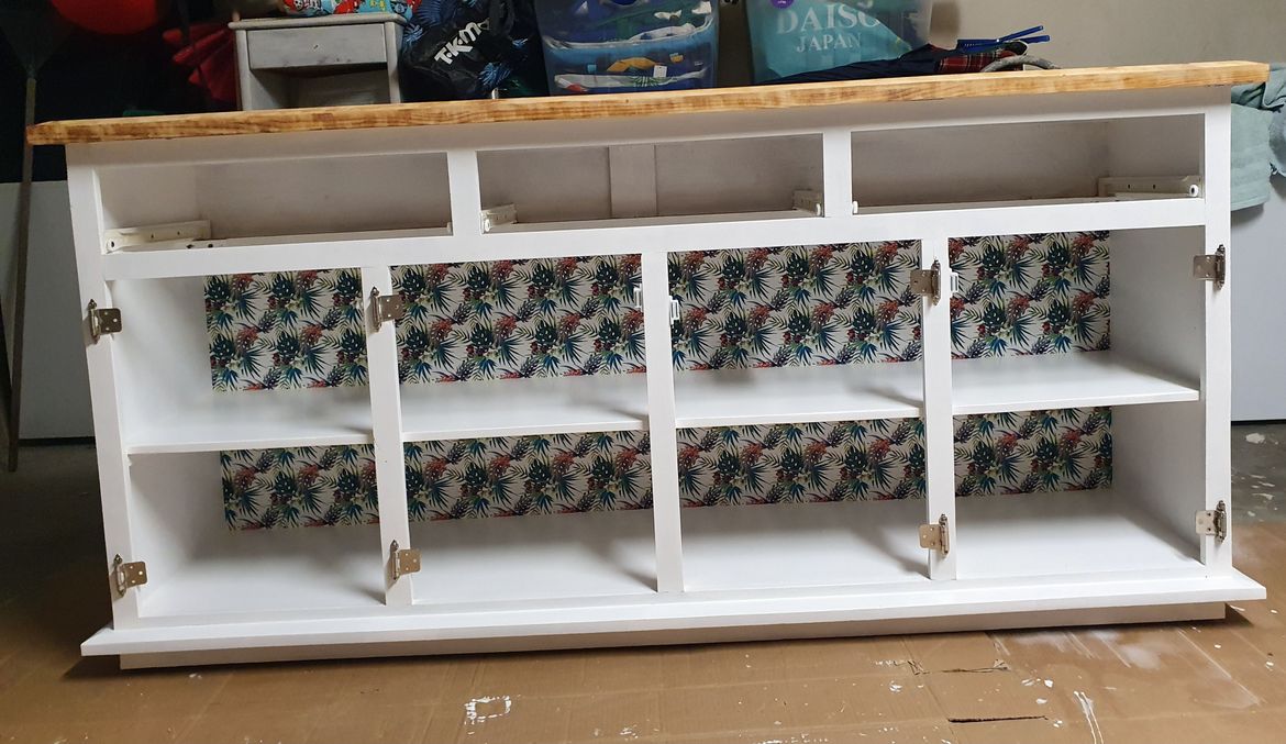

Here's some things I've done in the past. Hope I've helped. You can PM me if you need anything else
Before
During
During
After
TV cabinet
Bedside Table
Also @Emmalou34 if at all possible try to take the table apart so that you can get into all the nooks and crannies. And please don't paint over any hinges or decorative screws etc. It cheapens and diminishes all your hard work. I love watching furniture upscaling videos on Youtube too. Especially Transcend Furniture Gallery. She does beautiful work and you can get some good ideas
