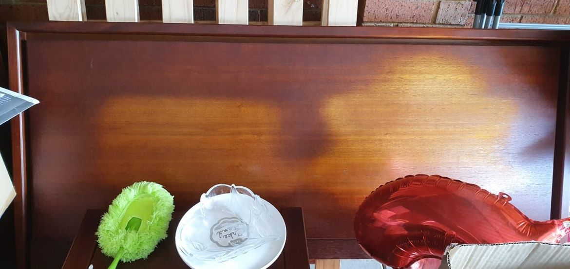

Like this bed frame is faded and I want to restore it.

Hi @rndxpert sorry for the late response. In your picture, are the lighter patches fading, or is that highlights from  light/window?  If it is actual fading, you have 2 choices.
1. Strip the varnish/satin off the entire piece, and then re-varnish/satin.
2. This is more difficult, but you find a stain/varnish that when added over the top of the faded section, brings it all back to the same colour. Very difficult, but some people who are arty can do this. Cheers Deb
