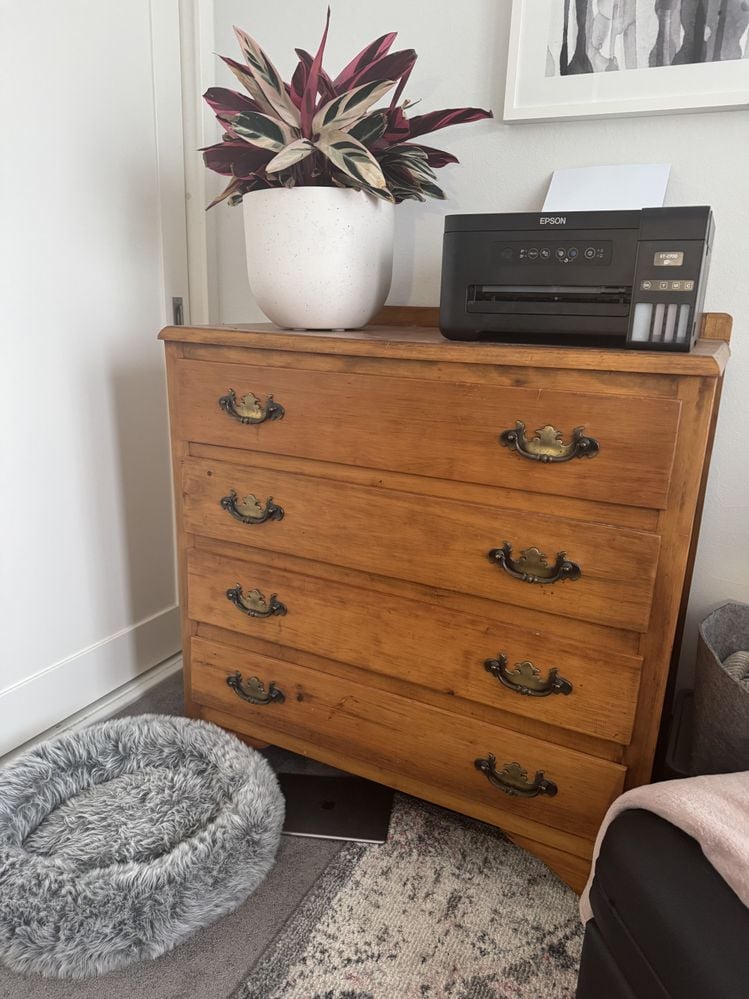

I've had these drawers FOREVER! Since I was a teenager. I'm now in my early 50s and I want get rid of the horrible orange finish. Years and years ago, Dad stripped them back and then just applied a coat of Estapol. What are the best steps to take to remove the Estapol and get the wood ready for a new finish?

The general steps are to sand the surface of the cabinet back to wood. I would suggest using an Ozito 200W Detail Sander as it comes with a set of sanding pads which should be enough to do a single cabinet. Once you've sanded down the cabinet, I recommend cleaning the surface of the cabinet with a clean rag and a vacuum cleaner with the soft brush attachment.
Once you've thoroughly cleaned it you can now stain, seal or paint the surface with your preferred finish. I recommend having a quick look at this discussion - Bedside tables makeover by @inspiredbycoast. It is an excellent example of how to achieve a modern finish on refurbished furniture.

I have a Ryobi 18V One Palm Sander. Will that work?
What grit sanding do I need to use?

My apologies for the delayed response. Yes, your Ryobi palm sander should be sufficient to remove the current sealer on your cabinet. I suggest starting with a 180grit sandpaper and finishing off with a 240grit for a nice finish.
