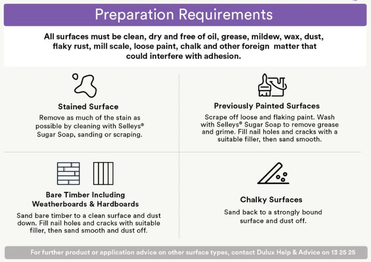

Someone with experience has recommended to me to first use
Dulux precision maximum adhesion and then for any more peeling paint remaining use zinsser peel stop.
what do you think of that  approach?
Re: Flaking lead paint ?
Hello @CRC
The Dulux precision is aimed more for difficult to paint surfaces especially if it is shinny or glossy. It may have similar characteristics as the Zinsser Peel Stop but it is not the same. I don't recommend using the Dulux Precision on the flaking pant. However, I believe preparation of the paint surface is critical especially when peeling and cracking are present.
