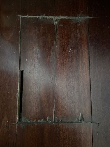

Hi everyone - I'm new here and have looked at some similar issues with gaps in hardwood floors but I couldn't find an exact answer for my particular problem.
I have recently moved into a very old house (circa 1910s build!) and there are a lot of square cutouts (trapdoor?) in the jarrah floorboards. Some of them are well sealed but there is one in particular that is quite loose and has a huge gap - 1cm wide and about 20cm long, see below:
For now I've the covered the gap with some painter's tape 😅 I know that a gap that big can't be closed with wood filler, but considering that it's only a small section of the floorboard that has already been cut, is it possible to DIY by sourcing a small section of jarrah floorboards to add to the existing floorboards? The whole area measures 26x40cm
Thanks!

If you can find a small piece of Jarrah to patch that gap, that would be the ideal solution. I'm quite confident that you can do it as a D.I.Y project. The challenge will be to find a stain that will match your current floor colour. Your best option is to go to the stores stain and varnish sample board in the paint department and bring one of your trap doors and see which one is similar to your floor finish. My best advice is to make sure to put a bucket over the hole in the floor while you are at the shop to make sure no one falls into it.

I would be inclined to try and source 2nd hand/used Jarrah floorboards and replace the left of both pieces as it will be your best chance to match the shade of finish. And yes an easy DIY project. The open section will allow you to pry up the first board.

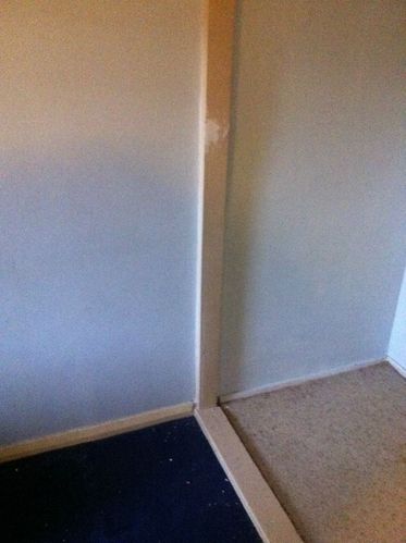

I would try and source replacement timbers and then switch them out once found. I have replaced a floorboard on a room join before with similar staining (was lucky to find one that matched the style of timber) I had to pack it up from underneath to make it level but you cant tell at all. The room was then sanded so I wasnt worried about matchy match other then the type of grain.
The base board cover that was covering an old wall plate

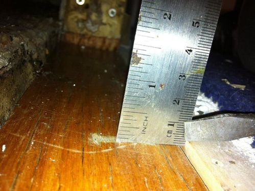

The size I had to find, in the end I found the same type but it was 17-18mm, so I had to pack it up to make it level

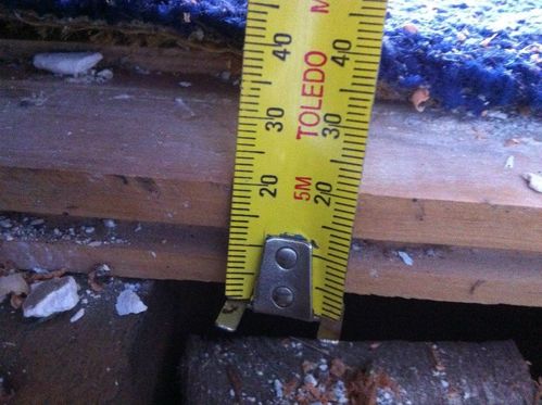

The new piece before I packed it up, The whole floor was then sanded back.
I hadnt done a match and replace job before but it was satisfying figuring out the heights :smile:
