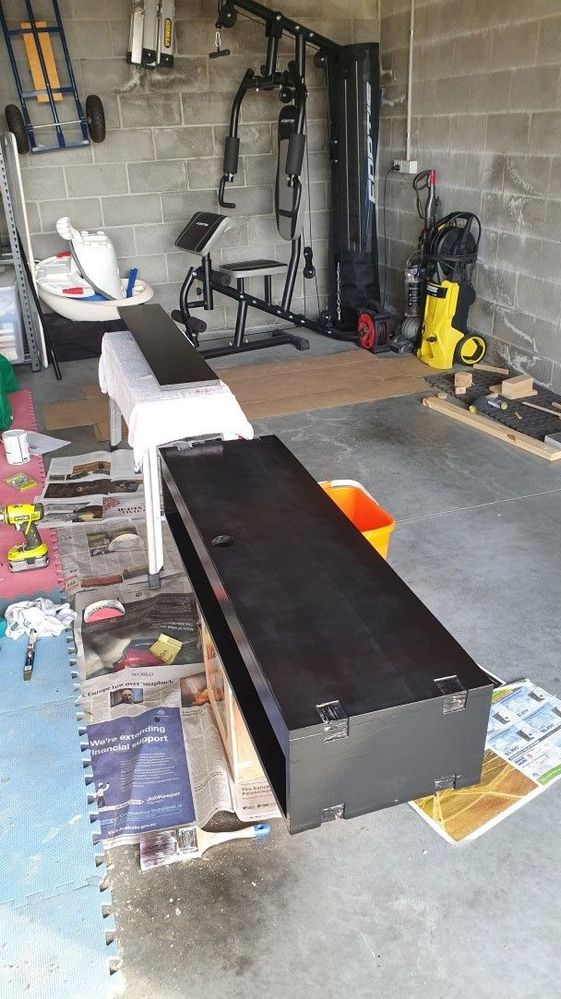

Hi guys - I started a DIY project 2 months ago to build a wall-mounted/floating media shelf that I designed.
Everything has gone great, except that now I am up to the final stage of painting/sanding back/ repainting and need advise on cealing/ varnishes.
On recommendation from a Bunnings staff member, I have painted the unit using Taubmans Ultimate Enamel (black) so that the surface comes up with a nice dark gloss.
However I've found that once the paint drys, touching it leaves fingerprint marks.
Is there a type of sealant or varnish that I can use which will s
al off the paint, keep the gloss look, but also prevent finger marks?
