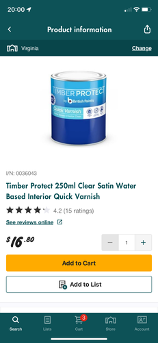

Thanks Mitchell. This is the varnish I have. I will give it a try on the underside, although how long does it take to start yellowing? I presumed this was an aging and uv exposure problem.

Hi @HandyBird,
The product you have chosen is an interior water-based varnish, so it should not be used in applications where it is regularly exposed to UV. As it is a clear satin varnish, there will be very little if any yellowing from this product.

Does that include through a window? Or does the type of UV that the glass allows through not cause yellowing? Secondly does the Cabot’s Cabothane have the same problem. It will be used on a desk next to a large window

Yes, UV rays will still come through a window.
The product you have chosen is a modern water-based varnish in the same way this Cabot's Cabothane Clear is. Modern water-based varnishes are not yellowing in the same way older oil-based varnishes are.
