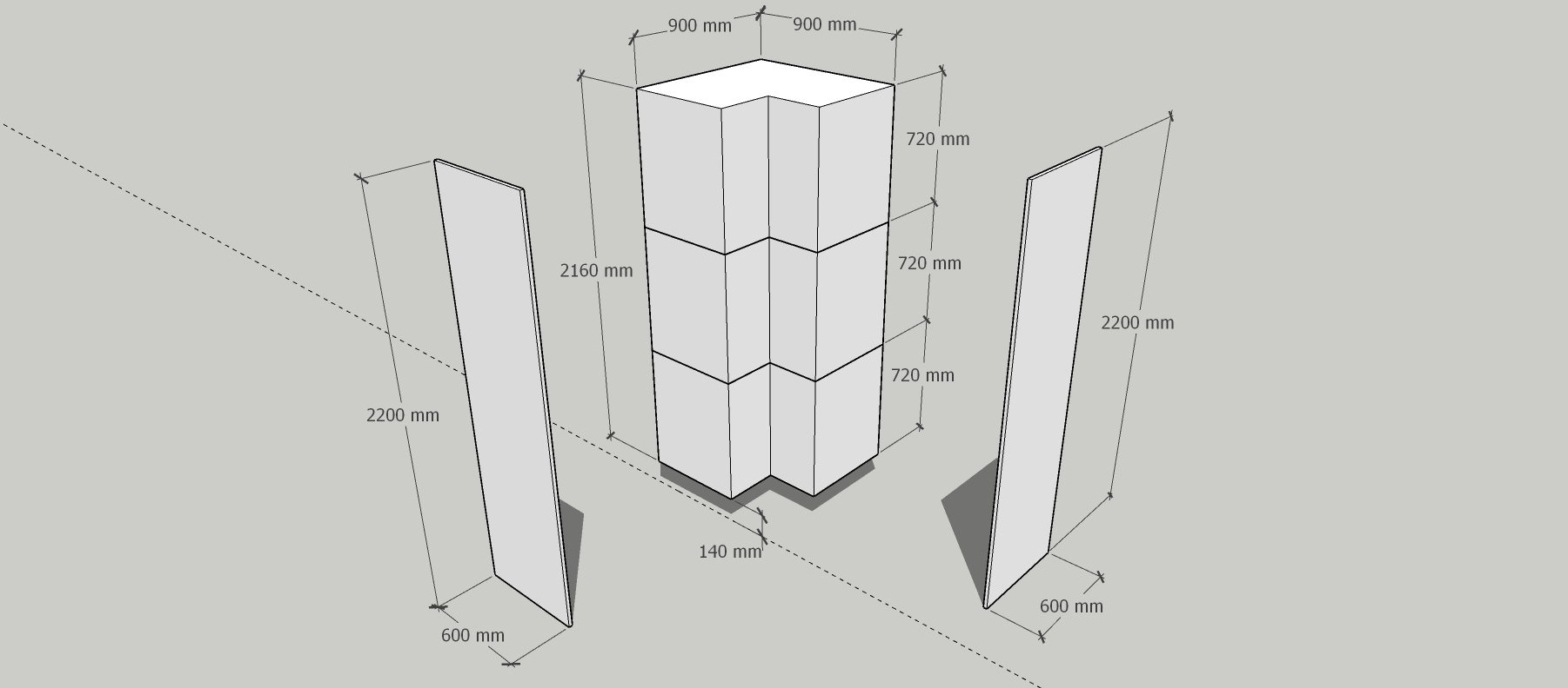

Just to give you a visual reference to Mitchell's recommendation, it is possible to stack three corner cabinets one on top of another. However, please be aware that you'll need to build a custom timber base plinth for the structure so that it does not go over 2200mm which is the full height of a pantry end panel. If you do decide to use the standard feet that comes with the cabinetry, you'll need to build a custom pantry panel and paint it.

Thanks for the tip I am going to use the timber skirting on a plinth as the base so it matches the surrounding walls. What is the lowest height the standard feet can go out of interest.

Hello @aussieorchid

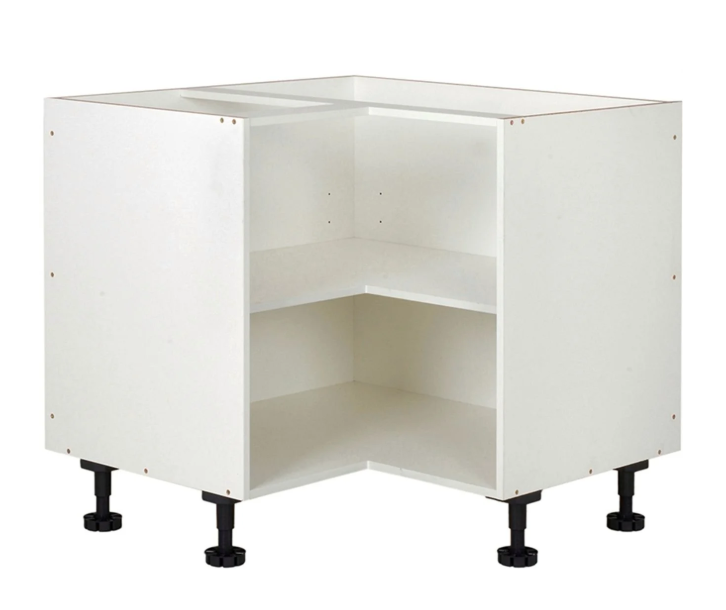

Conservatively, the lowest it can go is 100mm, but you will need to go lower if you are using the Kaboodle pantry panel. I propose using 40mm timber to build your plinth as this is close to the size you'll be needing to meet the necessary height measurements. I almost forgot, please keep in mind that the corner cabinet tops are open at the top. You'll need to create a cover panel for the last cabinet at the very top. I've placed an image of the Kaboodle cabinet below to give you a better idea of its structure.
