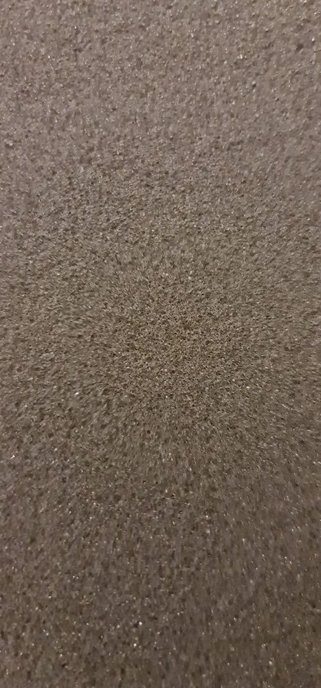

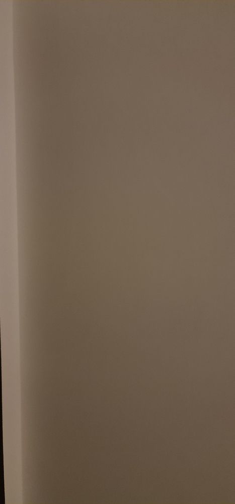

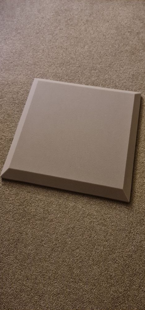

I live in an apartment and I think the wall is gyprock. Also attached are photos of the acoustic panel and the wall.
Thanks Kelvin

Are you planning to remove these panels at some time in the future? Or will you be attaching them permanently to the wall? Is the acoustic panel made of hard foam type material or is it soft foam?
Because of its porous nature, I suggest using Parfix 300g Clear All Purpose Silicone. It's highly flexible, and is noncorrosive which makes it safe to use on foam and rubber materials. I propose using masking tape to keep the panels up on the wall until the silicone cures.
