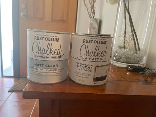

Hi I sanded back a pine table used 2 x coats white chalk paint, then used the recommended top coat (luckily a test patch) it has gone yellow. I can repaint over that with the chalk paint but what can I use to seal it without it going yellow. Thanks

rust-oleum chalked ultra Matt paint and same brand protective top coat.Matt clear. As advertised sec by salesman.

There are normally only two reasons why the coatings would yellow. The first is that there was a stain on the pine timber, which bled through. Sometimes, these stains don't bleed through until the topcoat clear is applied. The other reason is that the top coat was clear and applied in a coating that was too thick. The clear has a yellow tinge to it, so only a thin coat for protection should be applied.
If there were residual stains left on the pine, then it would be a case of needing to sand the chalk paint off and apply Zinsser B-I-N Primer Sealer Stain Killer - White. You could potentially apply it over the chalked paint, but adhesion would be a concern. It's best to apply it over the timber.
You might like to do another test section with a thinner coat of the protective clear to see if that was the issue.
